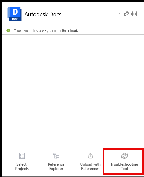

  1. Access the Troubleshooting tool from the Desktop Connector home screen.
    Troubleshooting tool selection in Desktop Connector home screen

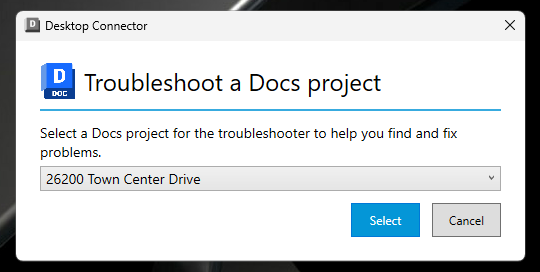

  2. Select the project you want to scan.
    Project selection screen in Troubleshooting tool
