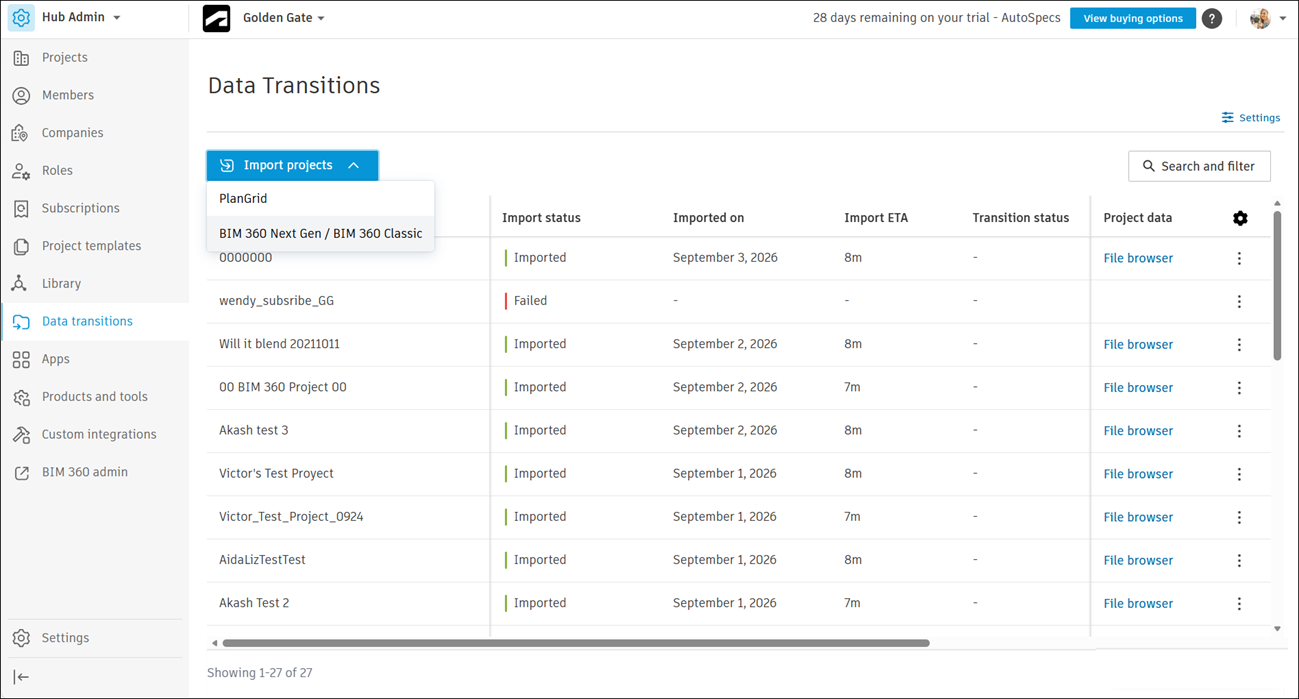

The data transition process is done in the Autodesk Forma Hub Admin.
From the project list select Hub Admin
On the left side select Data Transitions.
Click Import projects, then select BIM 360 Next Gen / BIM 360 Classic.

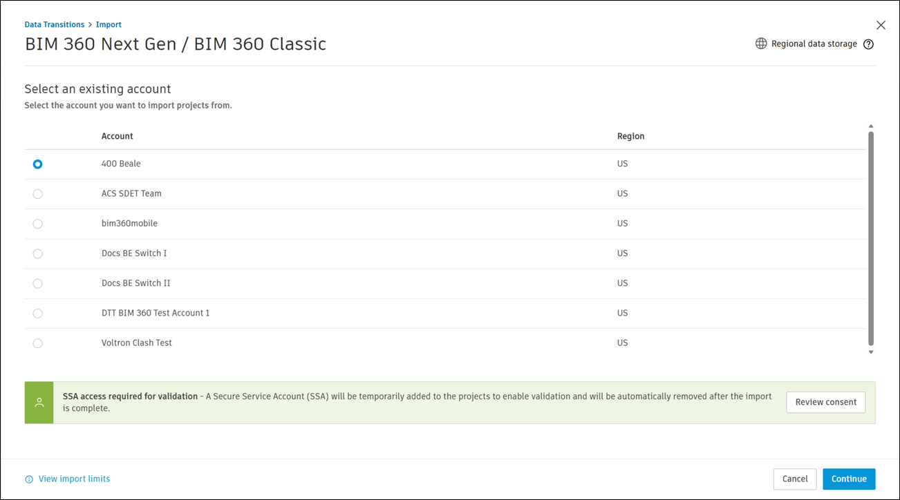

Select an existing account, then click Continue.
Note: Click Review consent in the SSA access required for validation banner to learn more about SSA accounts.

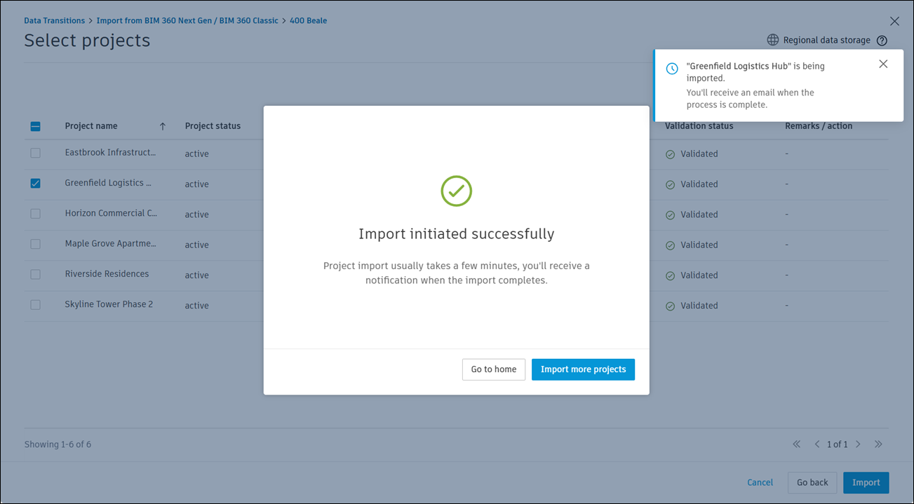

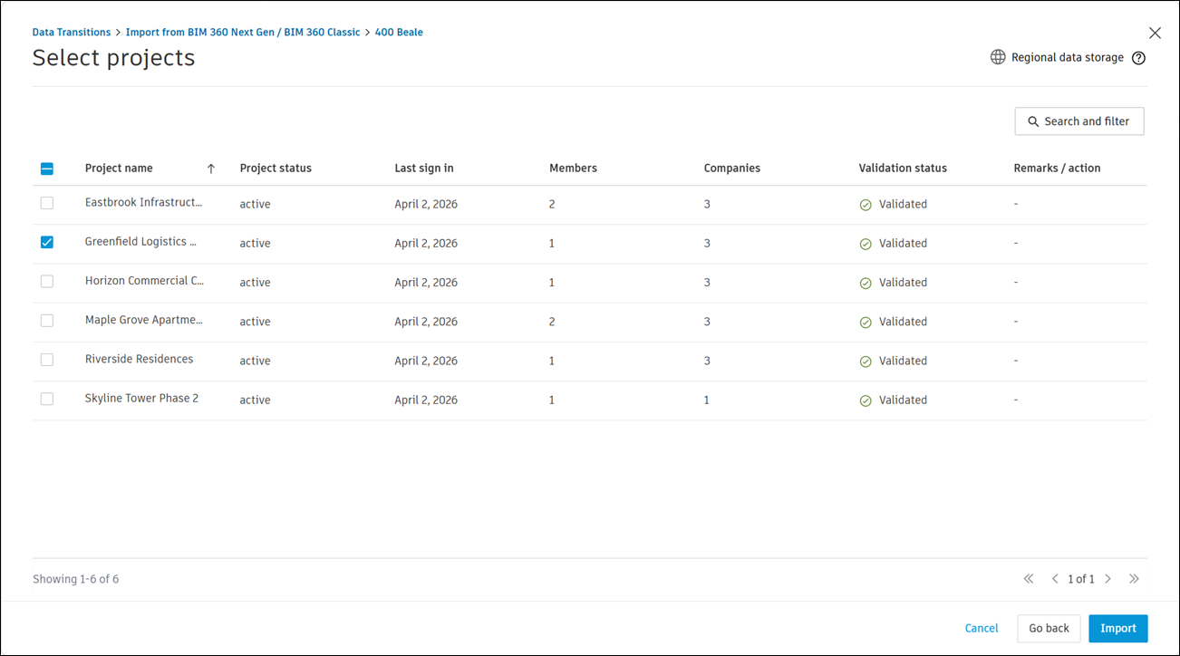

Select projects to import, then click Import.

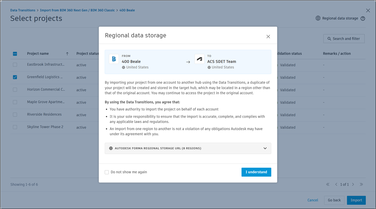

Review Regional data storage, then click I understand.
Once your import is initiated, you will see a screen similar to the following:

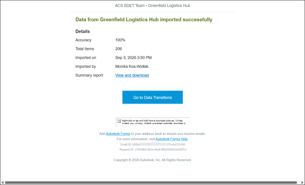

You'll receive an email one import is complete.

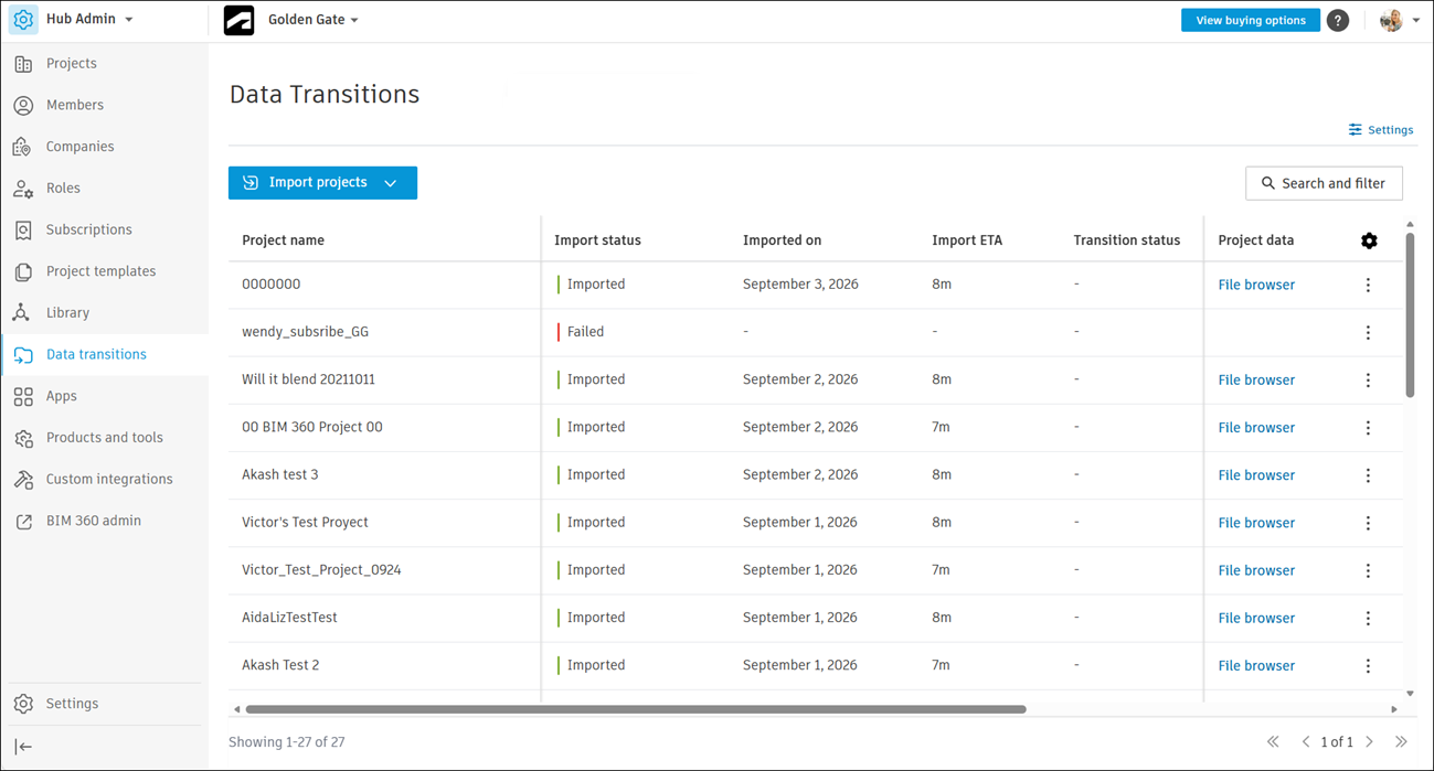

The Data Transitions table lists every project you've imported or attempted to import, along with its current state. Each row represents a single project and, by default, includes the following columns:
- Project name: The name of the project as it appears in the source platform.
- Validation status: The result of the pre-import validation check, such as Validated, Exceeded limit, or Failed.
- Import status: The result of the import operation, such as Imported, Partially imported, or Failed. A hover tip on Partially imported shows which items were skipped.
- Imported on: The date the project data finished importing.
- Import ETA: The estimated time remaining to complete the import.
- Transition status: The result of the move to Forma Data Management, such as Transitioned or Failed.
- Transitioned on: The date the project finished transitioning.
- Transition ETA: The estimated time remaining to complete the transition.
- Platform: The source platform the project came from, such as PlanGrid, BIM 360, or BIM 360 Field.
- Project data: A link, such as File browser, that opens the imported data for review.
- Action: Context-specific actions for the project, such as Retry or Revalidate.

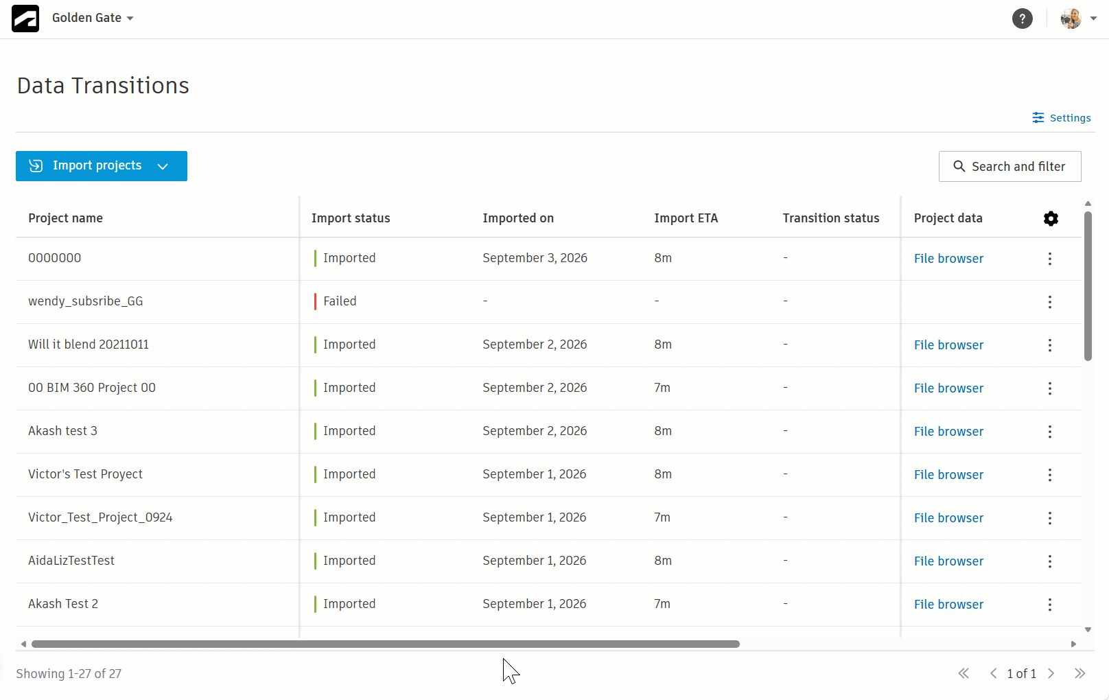

To customize the table view:
- Click the Settings icon
on the right of the table.
- Check the columns you want to display.
- Drag rows to reorder them as needed.
- Use the search box to filter columns by name.
