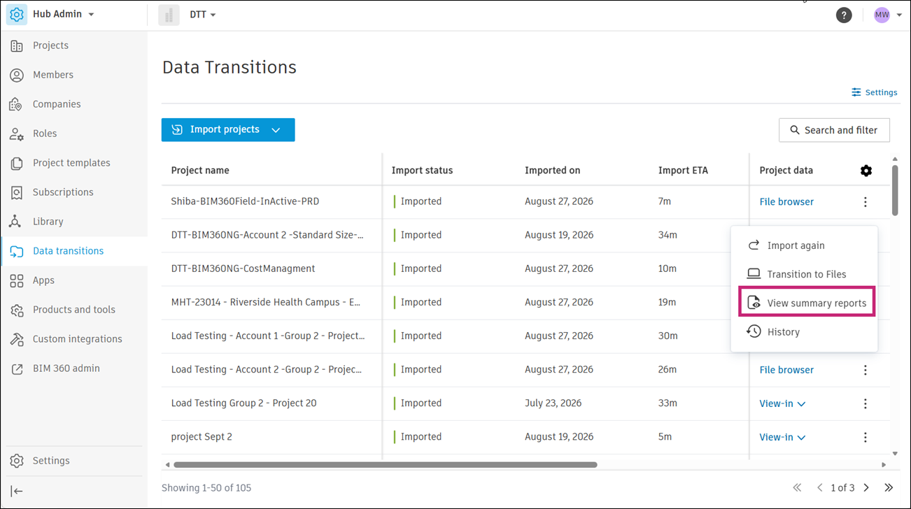

  1. Navigate to Hub Admin > Data transitions.
  2. Click the More menu on the right of the relevant row, select View summary reports.
    View Summary Reports

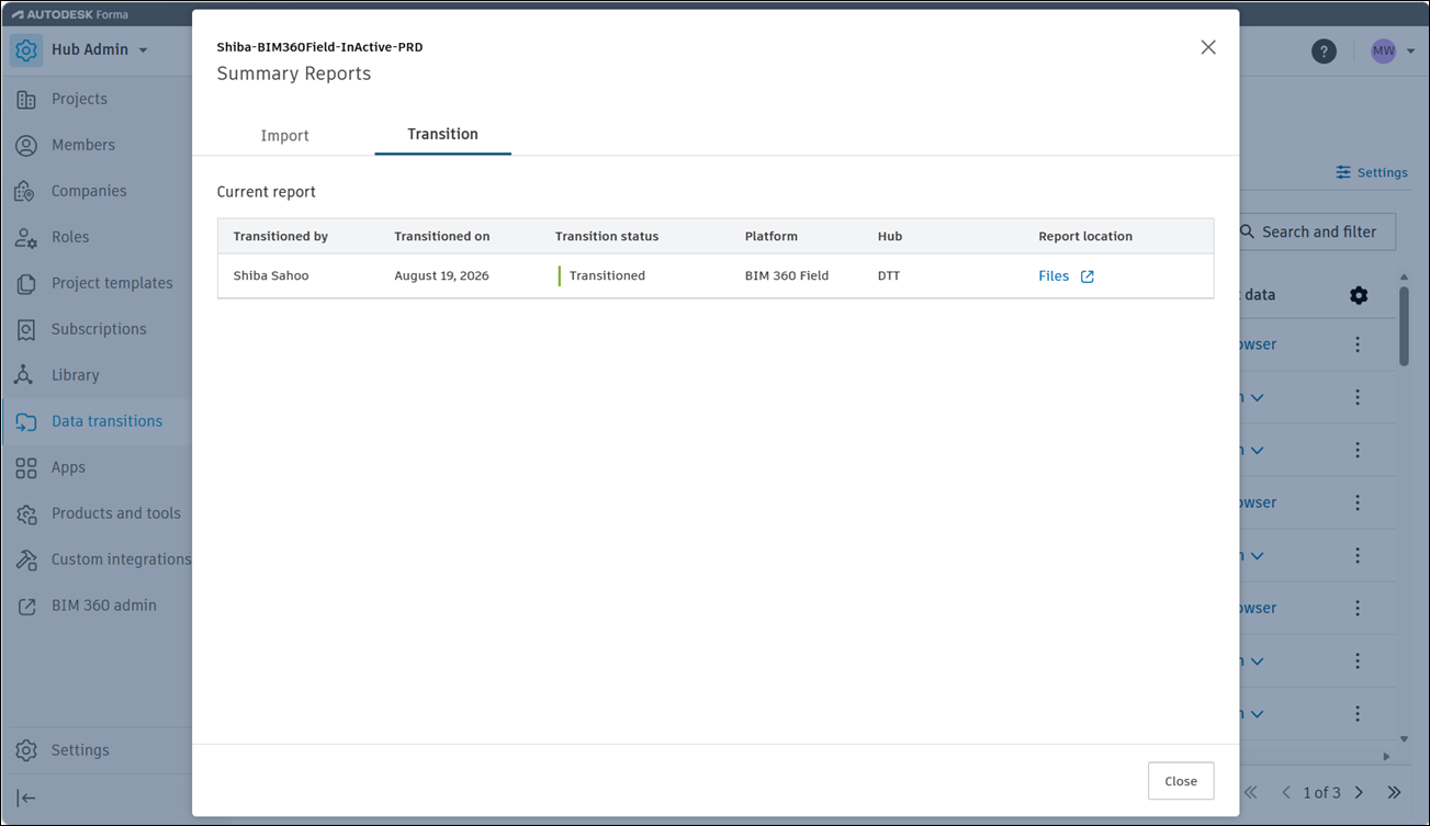

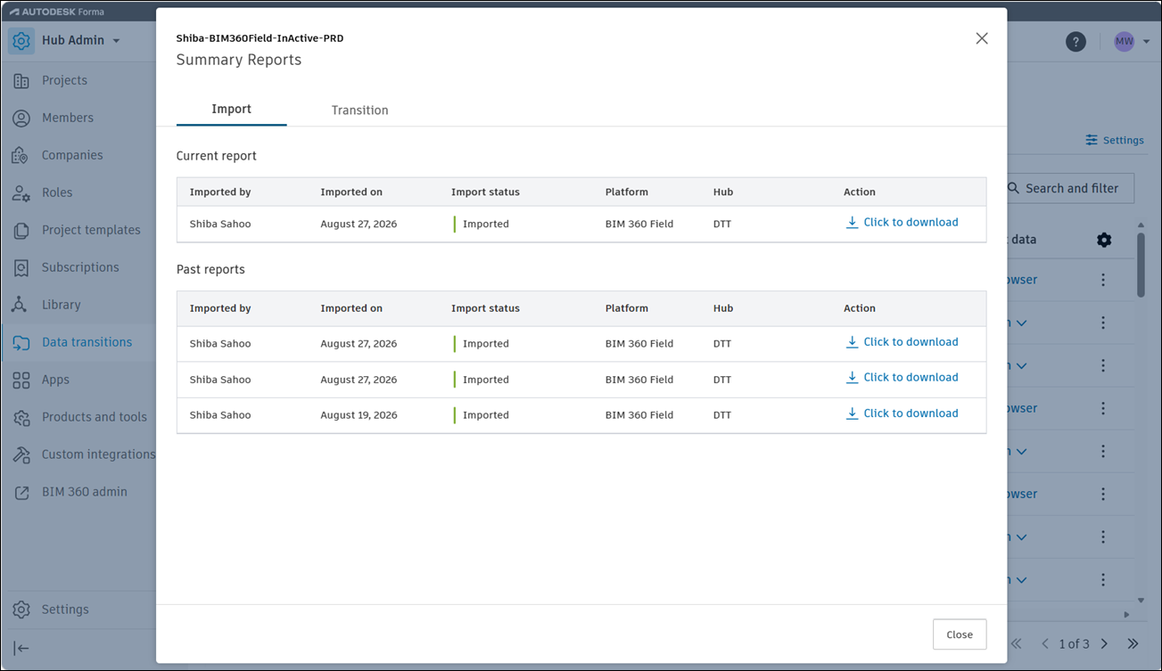

  3. Review the Summary Reports page.
    The page contains two tabs:
    • Import: Tracks data imports into Forma Data Management.
      • Current report: Displays the most recent import, with details about who imported the data, the import date, the import status, the source platform, the hub, and a link to the report location in the File browser.
      • Past reports: Lists previous imports, using the same columns as the current report.
        Tip: Click Close to close the page.
    • Transition: Tracks data transitions into Forma Data Management, including the current and past transition reports.

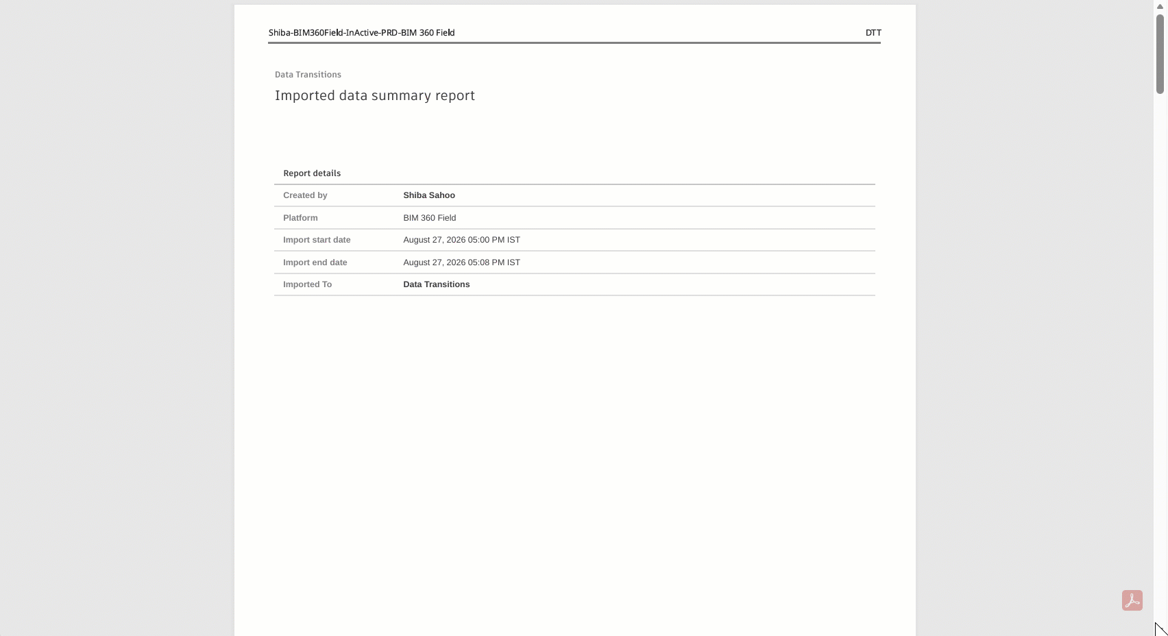

    The downloaded summary report shows the data that you imported into Forma Data Management, grouped by module. Use the report to confirm that the import completed and to identify any modules that failed.
