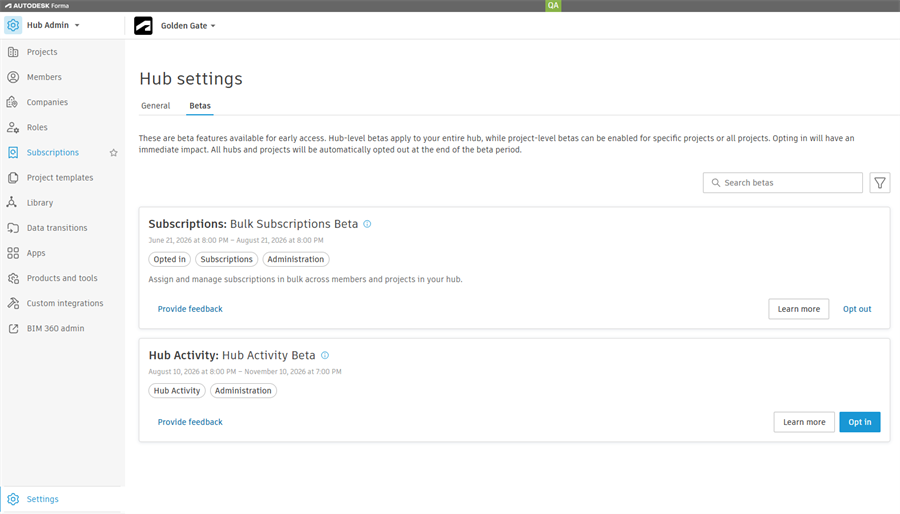

The Betas tab in hub settings lets hub administrators try new functionality before it's generally available. Each beta lists a name, an active date range, filterable tags, and a description. Click Learn more for details about a specific beta's functionality.
