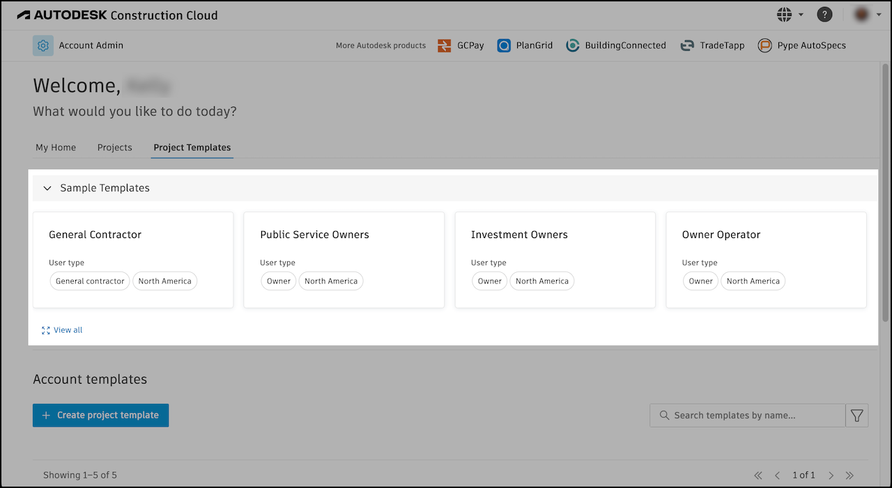

  1. Navigate to the Project Templates list using the project picker or from your Home page.
  2. Click Sample Templates to open the collapsible list of available sample templates.
    Sample project templates
  3. Click a project template card to view more details about the template, or click View all to see all the available templates and then click a project template.
A flyout panel will open with a description of the template, tags identifying the template like firm type or project need, and a list of what is included.
