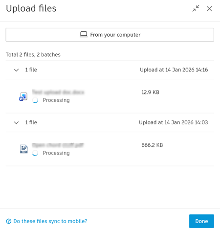

Upload Dialog
The Upload dialog opens whichever upload method you choose and lets you add files or a folder and shows the progress of the files and folders you've added.
Note: If you are adding files and the target folder has a naming standard applied or required attributes, the file names or required attributes will need validating. See Validate Files Names and Required Attribute Values to learn more.
Add Files or a folder
If you haven't already used drag and drop in the file list, you can drag files or a folder into the dropzone and repeat as necessary subject to the limitations.
Drag and drop also lets you add empty folders, or a parent folder with a mix of empty subfolders and the structure will be created in the target folder. As soon as you've added files or a folder to the upload session, you can add more files or another folder and repeat.
You can also add files or a folder from your computer using the Select files or Select a folder options. However, you can't upload a single empty folder and if you add a folder structure with a mix of empty folders, the empty folders will only be created to the depth of the last folder which contains a file.

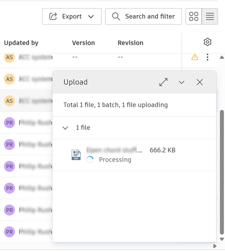

Track upload progress
As soon as you've added files or folders, the upload progress and any errors are listed. Folders are created first and are subject to a precheck which runs to check limits and naming conflicts. If the check finds no issues, the folders are created and the file uploads start automatically. If the precheck finds any issues, the upload doesn't start until the issues are resolved. You can resolve issues in the Upload dialog by removing problem files or folders, or remove the entire upload and fix issues locally before uploading again. Use this table to fix the most common issues.

Files and folder upload statuses
The status of your file and folder uploads are detailed in the Upload status column.
Folder statuses
Status Meaning
Queued Waiting to start.
Initializing The folder is undergoing the precheck.
Creating folder Precheck has passed and folders are being created before files are uploaded.
Uploading — # of # files Folder progress shown as the number of files uploading in the folder.
Upload complete All folders created and files uploaded successfully.
Upload failed Folder-level failure. Members can retry.
File statuses
Status Meaning / tooltip
Uploading — #% File upload progress shown as a %.
Initializing The uploaded folder containing the file is undergoing the precheck.
Upload complete File uploaded to the folder.
Upload failed File-level failure. Members can retry.
