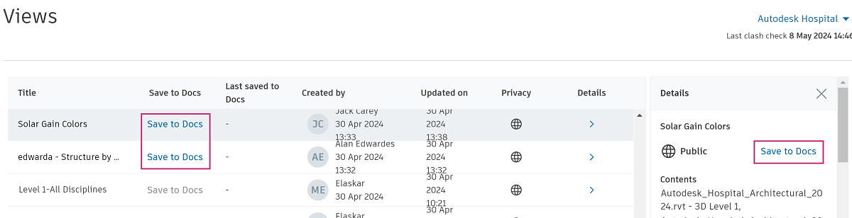

Create a view, or navigate to a view in the Views tool.
In the Views tool, click Save to Docs next to the relevant view.
Tip: You can also click in the Details column and access the Save to Docs button in the Details panel, or use the Save to Docs option in the viewer.
Click Save to Docs.

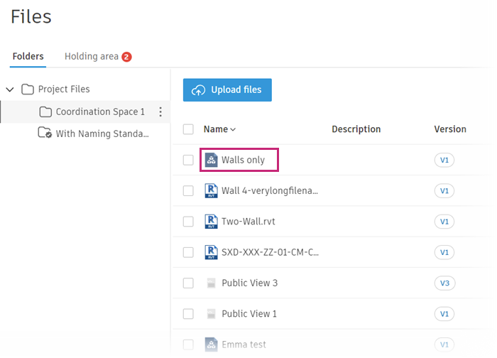

A snapshot file is created in Docs based on the view.
A snapshot file is a point-in-time capture of the view in its current state. If changes are made to the view in Model Coordination, repeat the process above to either overwrite the previous file (creating a new version), or create a new file in Docs.
To navigate to the file in Docs, access the Views tool and click the link in the Last saved to Docs column:
