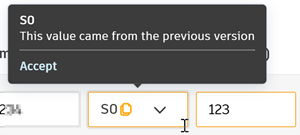

If the previous version of a file has related attribute values, these values will display in the relevant related attribute fields highlighted in yellow.
To accept a value, hover the field highlighted in yellow and click Accept. The field will stop highlighting.
You can also bulk accept these previous version attribute values by clicking:
If you don't want to see the previous values, turn off Show attribute values from previous version at the bottom of the validator. The fields will empty and the stop highlighting.
