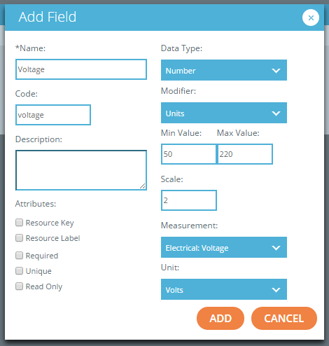

Number The Number data type stores floating point values. This field can have a minimum or maximum value. Additionally, the Number data type has a Scale attribute, which is the number of decimal places to display on reports. This attribute does not change the value stored in the system's underlying database, so the number is stored precisely even if no decimal places are shown on reports.
Modifiers
If a user selects this modifier, the abbreviation of the selected unit will appear next to the value whenever the system displays the field on reports.

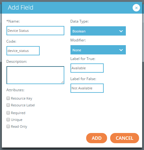

Boolean The Boolean data type is used to set flags. This data type is used when an object can be one of two states. The field can have the underlying value of True or False, but the user can also supply labels for each of these states.
For example, a field titled "Availability" could have the label "Available" for the true state and "Not Available" for the false state. Such fields appear on embedded editors or filters as a single checkbox with the label of the true state, under the title of the field, but they appear on reports as simply the label of their current states.
