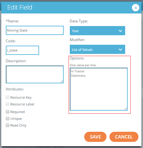

- List of Values
Stores a list of all possible values a field can assume. For example, a "Trailer" resource type could have a "Moving State" text field with this modifier, and the user could provide two possible values for that field: "In Transit" and "Stationary."
The system also supports validation for fields with this modifier.
For example, if a user enters text for a field that is not found in the list of values, the system displays an error message stating that the user has provided an invalid value.

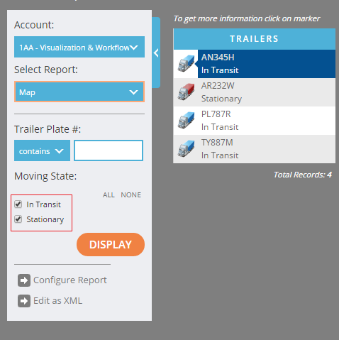

If a field with this modifier is used as a criterion in a report, that criterion will appear as a series of checkboxes on the filter of the report, one for each defined value.

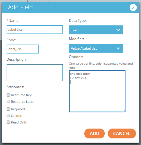

- Value/Label List
Separates a field into a Label that is displayed to users and a Value that is used in the Routines engine. The label in this pairing appears on reports, similar to a List Value. However, users can only input strings that match a defined label. The label also appears on checkboxes for a criterion.
When referencing a value in the Routines engine, such as checking whether a field is set to a certain value, users would enter the value in this pairing.

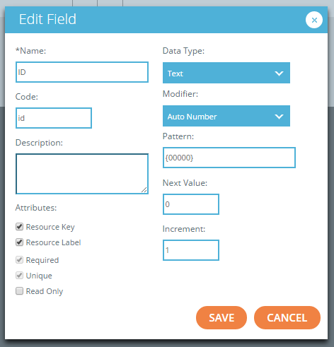

- Auto-Number
Used to create a numeric text field that is automatically set by the system when a new object is created. The value automatically increments for every record.
The Auto-Number modifier is particularly useful for an ID field of an object. For example, when an object (typically an event record) is created within a Routine, an ID is generated automatically, higher than that of the previous record created.
As shown in the following image, fields with this modifier require three pieces of information: the Pattern, the Next Value, and the Increment.
- Pattern— the format of the generated number. Should be enclosed in brackets.
- Next Value— the next value that should be generated. This value is used to set the first value of the assigned field upon creation or to skip to a higher number later on.
- Increment— the amount by which the field will increase for each subsequent object. In the above example, the first record will have "00000" ID, the second record "00001" ID, the third - "00002" ID, and so on.
