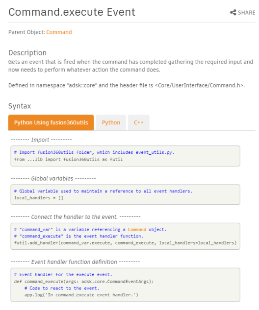

One thing to be aware of that can significantly simplify adding support for events is the "Syntax" portion of the help for every event shows example code for the event handler and connecting the handler to the event. You can copy and paste this code from the help, make minor edits to a couple of variable names, and you'll have the event implemented. There are two tabs for Python and one for C++. The reason for the two tabs with Python is that the tab labeled "Python Using fusion360utils" uses a library provided when you create a Python add-in. This library simplifies the implementation of events. The "Python" tab illustrates implementing an event handler without help from an external library.

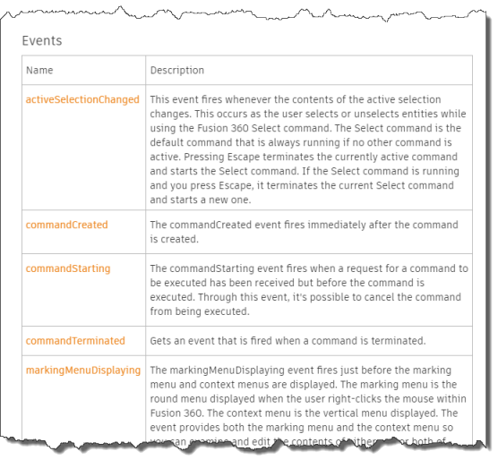

  1. The initial access to an event is through a property on the object that supports the event. For example, the UserInterface object supports the activeSelectionChanged, commandCreated, commandStarting, and several other events. These are accessed through properties of the same name on the UserInterface object. Events are listed in an "Events" section within the help topic of the object, as shown below.
