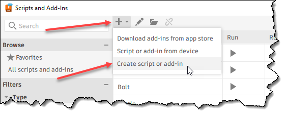

Run the Scripts and Add-Ins command from the UTILITIES tab in the toolbar, as shown below.
In the Scripts and Add-Ins dialog, click the “+” near the top of the dialog, and then choose "Create script or add-in" from the drop-down list, as shown below.
In the “New App” dialog, make sure “Script” and “Python” are selected. Enter a name for the script name, and optionally enter the “Description”, and “Author” fields and then click “Create”. This will take you back to the “Scripts and Add-Ins” dialog.

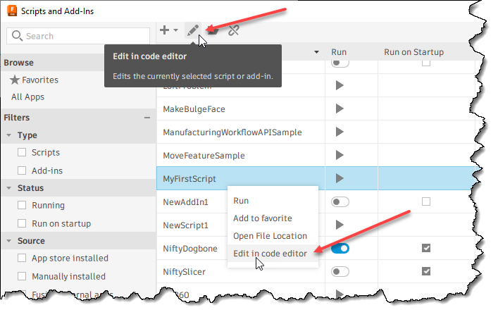

The new script will now be shown in the list. To edit it, use the "Edit in code editor" command from the toolbar at the top of the list section or the context menu, as shown below.
For Python programs, Fusion uses Visual Studio Code (VS Code) as the development environment. If it is not already installed when you try to edit or debug, Fusion will display the dialog below to install VS Code. You only need to do this the first time you edit any script or add-in. When VS Code finishes installing, do the Edit step again to open the script in VS Code.
The first time you run VS Code from Fusion, you will see a window pop-up saying an extension is being installed. Fusion is installing the Python extension for VS Code. This also only needs to be done once. Finally, once everything is installed VS Code will open, as shown below.

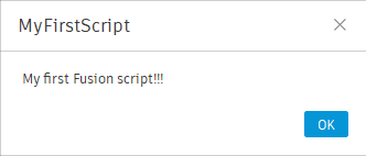

You can now use VS Code to edit your program. For this simple example, edit the text for the messageBox to any message you would like, such as what's shown below, and save the changes.

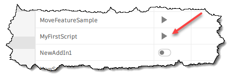

Congratulations, you have just written your first script. To run your script, run the Scripts and Add-Ins command, find your script in the list, and click the
icon beside it.
The script will run and do whatever it is programmed to do. In this case it will display the message box shown below.
