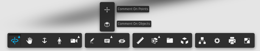

Comment on specific parts of a design
Use the Comment on Objects and Comment on Points tools to leave feedback on specific areas of a design.
comment on point and object
Comment on Points
Use this tool to highlight a specific point on the design:
  1. In the Fusion web client, in the toolbar at the bottom of the Viewer's canvas, click the Comment icon and select Comment On Points.
  2. Drag the blue guides to the point where you want to leave a comment.
  3. Click to place the marker and open the comment box.
    To reposition the marker, drag the guides to a new point.
  4. Enter your comment in the comment box.
  5. Click Post.
Comment on Objects
Use this tool to highlight a specific object within a design.
  1. In the Fusion web client, in the toolbar at the bottom of the Viewer's canvas, click the Comment icon and select Comment On Objects.
  2. Click the object you want to comment on.
    A marker is added and the comment box opens.
  3. Enter your comment in the comment box.
  4. Click Post.

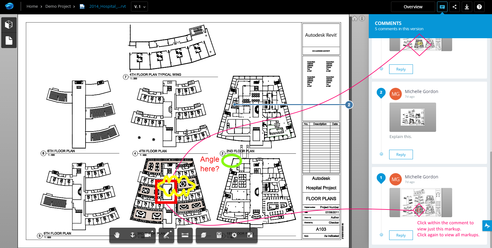

View comments
You can view all comments in the Comments panel. In the Fusion web client, click the Comments icon comment icon in the top-right corner of the navigation bar to view comments.
Comments on points and objects are marked by blue pins in the canvas. You have the option to show or hide these markers by clicking Show Markers in the toolbar.
show markers
Hover over a marker to view the comment.
Respond to a comment
  1. Click the comment marker on the canvas.
  2. Click Reply below the comment.
  3. Enter your reply in the comments box.
  4. Click Post.
reply to comment

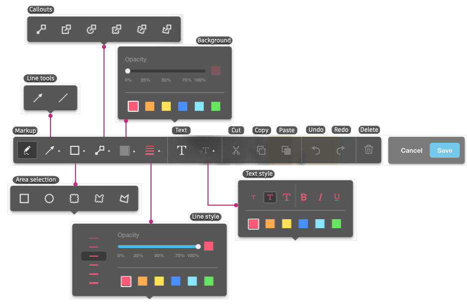

Mark up shared designs
When someone shares a link to a design with you, you can add feedback using Markup tools in the Viewer. After making your changes, save a snapshot of your feedback and share it with others.
  1. Click the shared link to open the design in the Viewer.
  2. In the toolbar, click the Markup icon markup icon to enter Markup Mode.
Note: Only a subset of Markup tools available in the Fusion web client can be used for shared designs.
While in Markup Mode:
The Markup toolbar includes the following types of tools:
You can change the style and format for these using:
markup all tools as of March 2025
You can use these tools to mark up any part of the design.
To use the drawing tools, select an option and click anywhere over your design and draw. When you save the markup, a marker is added to the design.
To add a callout, click the Callout menu, select the callout option you want. The following Callout options are available:
You can set the background and background opacity for the following types of markup:
To change the color or size of your markup:
  1. Select the Line Style tools.
  2. Set color, width, and opacity.
The selections are retained for all markup tools until you change them.
If you want to set the background color of any of these options to white, reduce opacity to zero.
To create a text box, select the Text tool and click anywhere on the screen. Type within the text box.
  1. Use the Markup tools to mark up and add feedback to the design.
  2. Click Save Snapshot.
    Note: Markup changes you add will remain on the Viewer canvas till you click Cancel or Save Snapshot. You may add all your markup changes before saving the snapshot or save several snapshots.
  3. Provide a name for the image > Save.
  4. Select Save File.
  5. Browse to the folder you want to save in > Save.
Edit markups
All markup content can be moved and resized using the handles of the markup. You can also cut, copy, and paste markups, undo and redo actions on them, and delete them. You can edit text within the text boxes until you save the mark up. Click within the text box and make changes to your text.
When you are done adding markups and comments, click Save. If you add a markup on the design, a blue pin is added.
Review markups
To view markup changes, click Show Markers or open the Comments panel. Hover over a marker or click the comment that includes a markup to view the markup. The design view will change to the viewpoint at which the markup was added.
View a marked up 2D file
When you open a 2D file that has been marked up in the Viewer, all markups for that change to the file will be visible. You can show or hide these markups by clicking Hide/Show Markers within the Comment & Markup Utilities. To view a specific markup and related comments, open the Comments Panel and click the comment for that markup. All other markups will be dimmed. To view all markups again, click the selected comment again.
Tip: To find the corresponding comment for a markup, look at the snapshot in the comment.
Adding Markups to a marked up 2D file
When you click Markup to add markups, all existing markups are visible in a dimmed state and you can add markups over existing markups.
markup 2D files
