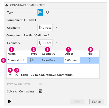

Constraint table
- Name: Enter a meaningful name for the constraint or accept the default name.
- Geometry: Displays the geometry that is selected for that constraint row.
- Offset
- Distance Offset (Align): Enter a distance value to offset between the selected geometry.
- Angle Offset (Angle): Enter the angle value for the relative angle between the selected geometry.
- Flip
: Flips the orientation of the selected geometry.
- Constraint row: Add more rows to create a set.
- Add Constraint
: Adds a new constraint row to the table.
- Delete Constraint
: Deletes the active constraint row.
Geometry column
The geometry pair that displays represents the constrained geometry for that constraint row.
For example, if a face is selected for Component 1 and an edge is selected for Component 2, the table will display: Face-Edge.
If no geometry selected for either component, Undefined displays in the table.
If the geometry for only Component 1 is defined, Face--- displays in the table.
