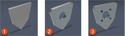

three backplates
  1. Variation with a bit of extra material to create a cost analysis that might be a little more than what actual costs will be, to help with budget planning.
  2. Simple variation used for demonstrations or sharing without divulging proprietary information.
  3. Variation closer to what the final product will be; for example, this version might provide more accurate stress analysis.

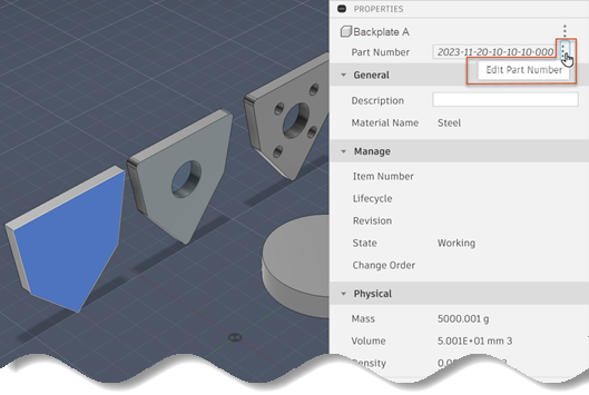

Assign a part number to the first model
When you create and save a model for the first time, and you use the New Part Number option in the Save As dialog, Fusion automatically generates a unique, time-based part value for the number, such as 2023-11-20-10-10-10-000. You can use the Properties panel to change this to your own unique part number, such as ABC-1.
  1. If necessary, click the Show Data Panel icon data panel icon to open the Data Panel.

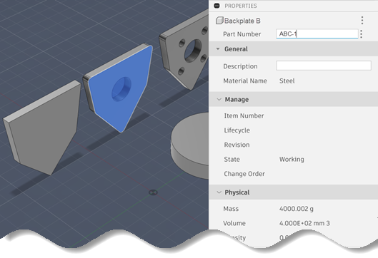

  2. In the Fusion Browser, right-click the component and select Properties.
  3. In the Properties panel that opens, beside the Part Number box, click More more and select Edit Part Number.
    properties
  4. In the Part Number box, enter a unique part number for the component.
    part number
  5. Save your design to record the change.

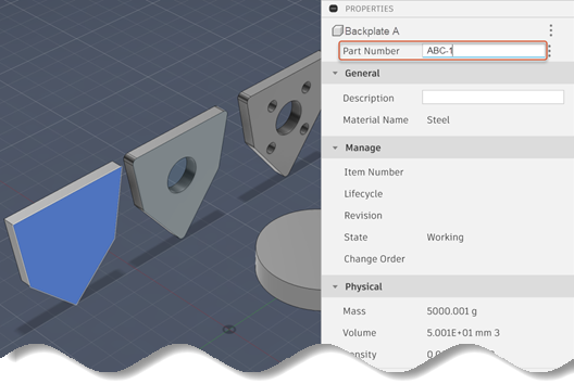

  1. Repeat the the preceding procedure for the second component and assign the same part number to it (ABC-1).
    properties
    When you enter the part number in the Properties dialog, Fusion detects it is already in use and will prompt you to confirm that you want to share the number between the components.

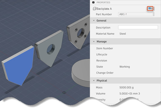

    Once the part number has been saved, an icon at the top of the dialog indicates that this component is a secondary component secondary icon to the first (primary) component.
    secondary indication
  3. Reopen Properties for the first component and check the icon at the top of the dialog.
    properties
    The primary icon primary icon indicates that the first component is now considered to be the primary component. This is expected, since it was the first component to be given this part number.

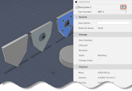

  1. Repeat the steps of the preceding procedure, but on the third component.
    Like in the preceding procedure, this component is now considered to be secondary, which is indicated by the secondary icon secondary icon.
    properties
  2. To make this the primary component, click More more icon beside the shared part number icon (secondary icon) and select Make primary.
    make primary
    The icon changes to indicate that this is now the primary component.
    primary component

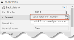

  1. In the Fusion Browser, right-click the component and select Properties.
  2. In the Properties panel that opens, beside the Part Number box, click More more and select Edit shared part number.
    primary component
