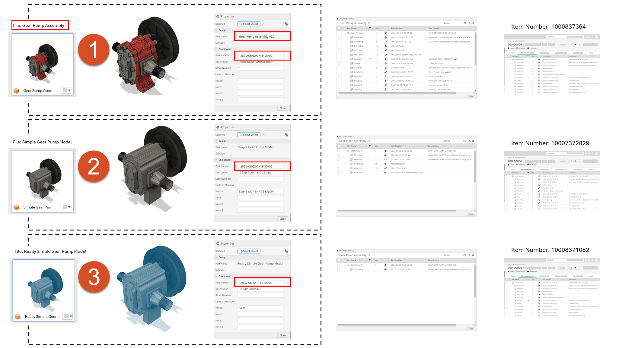

Traditionally, multiple models of the same real-world component lead to multiple BOMs, each associated with different properties and file names. This can cause issues such as:
Example
Consider a component like a pump. Multiple models of this pump might be created for various reasons.
multiple models
  1. Large model requiring more memory for maintenance
  2. Proprietary information removed so the model can be shared with anyone.
  3. Simplified model for specific assemblies.
These multiple models result in separate files and BOMs. This can make it difficult to reconcile data later, potentially leading to expensive mistakes, such as the wrong variant of the model being used for procurement or manufacturing, and so on.

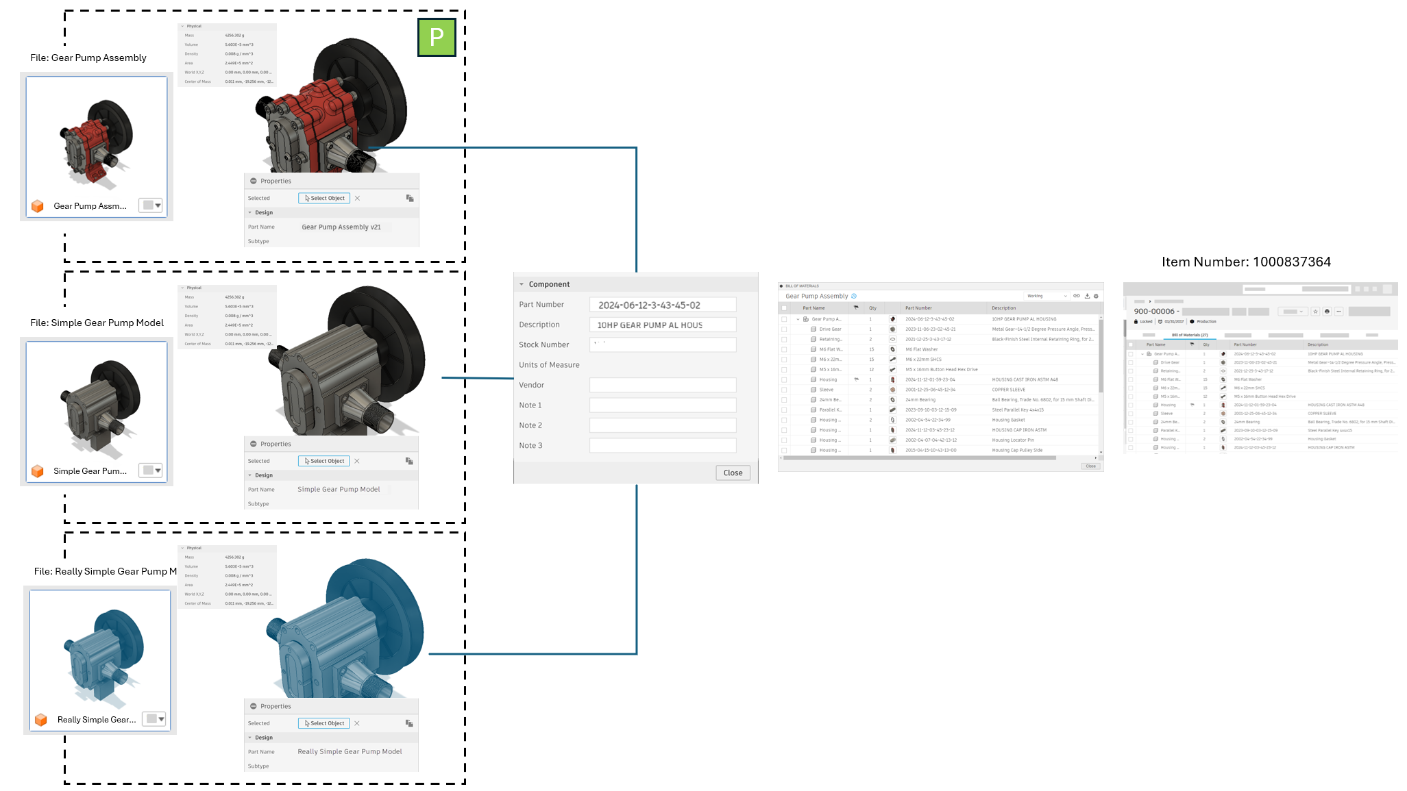

Unified part number and properties
Shared part numbers address these issues by associating a single part number with all related models and their properties.
unified models
Key points include:
When a version or change is recorded for a model with a shared part number, it is recorded for all models with that shared part number.
Primary model concept
To make sure that correct components are displayed in the BOM, shared part numbers include the concept of a primary model. You specify one variant of the model as the primary. The other variants then become secondary models. You can switch which variant is the primary at any time. The primary model determines which set of components is the one that should be shown in the BOM.
The single part number that owns all these properties also owns the BOM. The BOM is associated with the part number, not the model directly. You end up with a single part number, with a single set of properties, and a single BOM. If you’re working in an assembly and you insert this pump, you will always see the same BOM and properties for it, no matter which model variant you are using.
