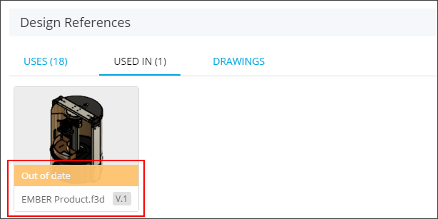

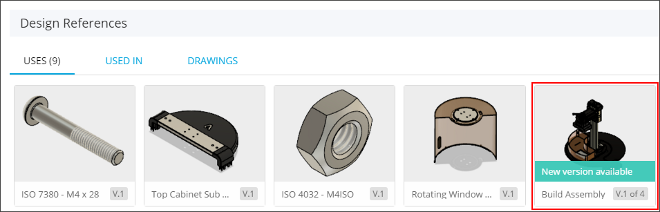

The Design References section shows relationships between designs and assemblies in Fusion. These relationships include:
If a design reference gets updated, both the parent and child design will be marked with the following:
New version available
Out of date

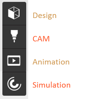

In the top-left corner of the Viewer, you can switch between different types of related data (if available).

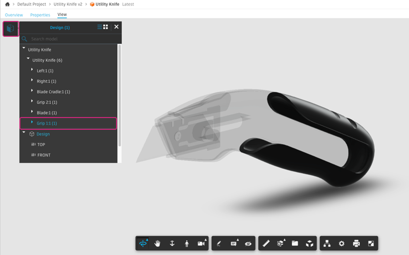

You can view, select, and isolate parts in a design using one of the following methods:
This image above shows a selected part within a design. Right-click on the part to access additional options:
Isolate: Make all other parts transparent.
Hide: Hide the selected part.
Show all objects: Display all parts with their default appearance.
Focus: Zoom in on the selected part.
Clear selection: Deselect the part.
Section: Create a section box or plane around the part.
Properties: Display the properties of the part.

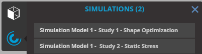

You can view results for the following types of simulation studies in the Viewer:
To view the results of simulation studies for a Fusion design:
Click the Simulation icon in the top-left corner of the Viewer to open the Browser.
Select a study to view its results.

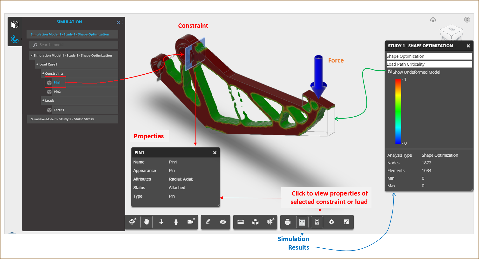

Expand the study in the Browser to see the applied constraints and loads.
Select a load or constraint and click the Properties button in the Viewer toolbar to view its properties.
Select Show Undeformed model in the Simulation Results pane to view the outline of the original model.

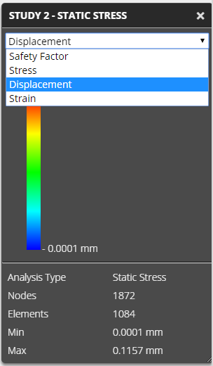

For studies that produce multiple result types, select the result contour plot that you want to view.
