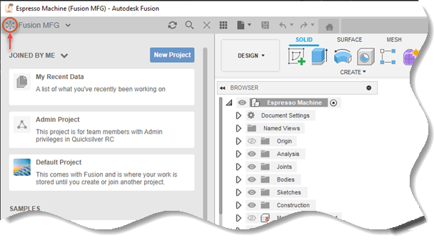

In Fusion
  1. If necessary, click the Show Data Panel icon data panel icon to open the Data Panel.
  2. Next to the hub name at the top left of the Fusion window, check for the collaborative editing icon collaborative editing.
    fusion ce
    If the icon is there, the hub supports collaborative editing.

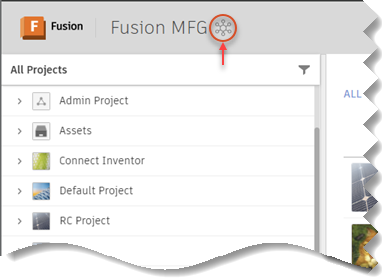

In the Fusion web client
