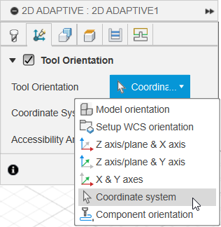

Create or edit an operation.
In the operation dialog, in the Multi-Axis tab, select the Tool Orientation checkbox.
In the Tool Orientation list, select Coordinate System.

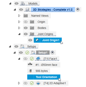

In the Browser, under Models, select a Joint Origin node, or under Setups, under an existing operation, select a previously defined Tool Orientation.
