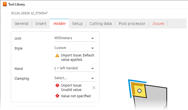

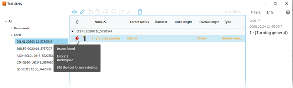

If there are any import issues with an imported tool, Fusion indicates these with an error icon
or a warning icon
next to the tool. Edit the tool for more details about the import issues.
Import errors occur when a tool parameter has a missing value. This can be because the file did not contain one initially or the value in the file is not supported by Fusion. You cannot use the tool until you provide a valid value.
Import warnings occur when Fusion assigns a default value to a tool parameter. This is because the file did not contain a value initially or the value in the file is not supported by Fusion. Verify the default value for the parameter before using the tool.
In the dialog that opens when editing a tool, any tabs containing parameters with import errors are highlighted red.
