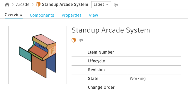

If the Fusion Manage Extension is enabled, additional columns are available:
- Item Number: the assigned Fusion Manage item number
- Lifecycle: the current lifecycle state of the assigned item
- Revision: the revision from the last change order associated with this version of the component

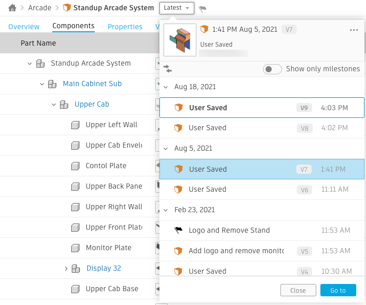

View a different version of the design
Use the History menu to view a different version of the design. The components for the selected version display in the Components tab.
Click the History menu.
Select a version from the list.
Click Go to.
You can filter the history to show only design versions that are milestones.
- Click Show only milestones.

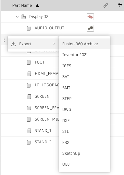

Export a component
Place the mouse pointer over the component to export.
Click the Action menu and then select Export.
Select the format.
