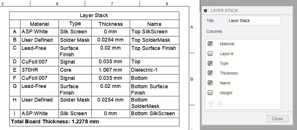

Add a table based on the PCB Layer Stack into your drawing in the Drawing workspace in Fusion.
  1. In the Drawing workspace, on the Electronics toolbar, click Tables > Layer Stack Table layer stack table icon.
    The Insert Layer Stack Table dialog displays.
  2. In the Insert Layer Stack Table dialog, select Layer Stack from the Table drop-down list.
  3. (Optional) Change the title of the layer stack table.
  4. (Optional) Show or hide columns in the Layer Stack Table dialog.
  5. (Optional) Use the Up and Down arrows in the Layer Stack Table dialog to change the order of the columns.
    drawing electronics design
  6. Click to place the layer stack table on the sheet.
    The layer stack table displays on the sheet.
