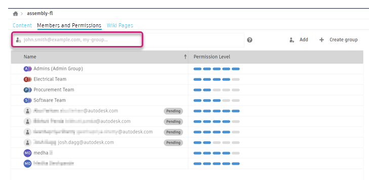

  1. In the Fusion web client, navigate to the project you want to search.
  2. Click the Members and Permissions tab.
  3. Type the name of the person or group you are looking for in the search box.

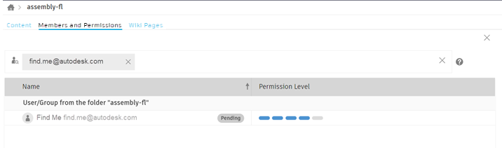

    search box
    If the name matches a member of the hub, Fusion detects it and populates the box accordingly.
  4. Press Enter to show the results, which include the member's name and permission level.
    search result
