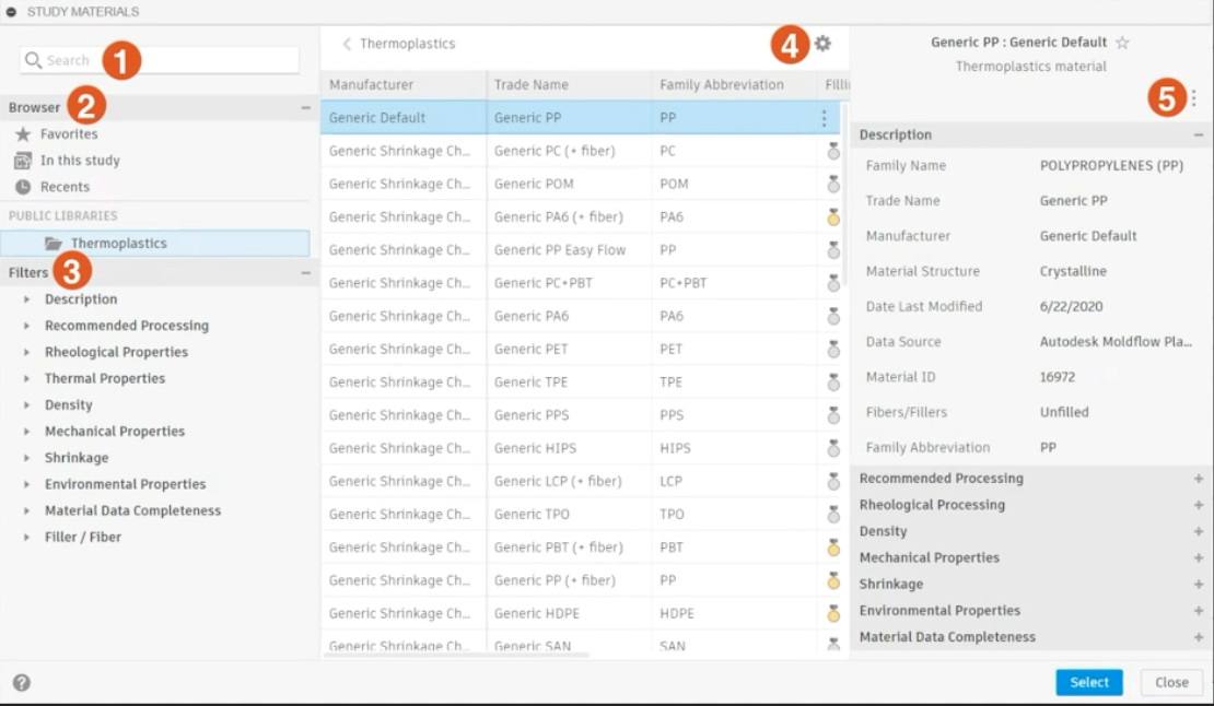

study materials dialog
The tools available in the Study Materials dialog.
  1. Search box - searches for materials using one or more of the following criteria: Manufacturer name, Trade Name, Family Abbreviation, or Family Name.
  2. Browser - enables you to quickly display data for your favorite materials, material used in the current study, or recently selected.
  3. Filters - enable you to search for materials that meet specific requirements in terms of properties or processing.
  4. Here you can customize the list of columns per page.
  5. Click more icon to open the menu from which you can add to favorites, view material properties, and set as your default material.
