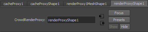

The Crowd Render Proxy node is automatically created at same time than a Simulation Cache Proxy and is attached to it as a dependency node:

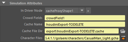

Simulation Attributes
In Driver Node Golaem Simulation Cache Proxy node from which this node attributes will be connected
Crowd Fields Name of the Crowd Fields to render. Separate the names with ;
Cache Name Name of the Simulation Cache to render
Cache File Dir Directory from where the Simulation Cache files have been exported
Character Files File paths of the Character Files (.gcha) used to export the Simulation Cache (i.e. the Character Files loaded in each Entity Type node). Open the Character Files in the Character Maker by clicking on

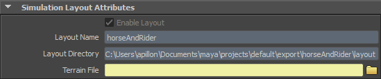

Simulation Layout Attributes
Enable Layout If checked, the result of the deformation layers contained in the specified Layout file will be applied on the rendered Entities
Layout Name Name of the Layout file (.gscl) to apply to the render. The applied Layout file can be changed using the Simulation Cache Layout Tool
Cache File Dir Directory from where the Layout file is read. The applied Layout file can be changed using the Simulation Cache Layout Tool
Terrain File File path to the terrain geometry on which the Entities will be adapted when applying the deformations stored in the Layout File at render time. If none is specified, Entities will be adapted to the simulation Terrain.

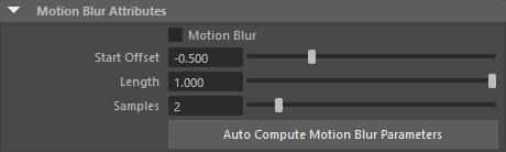

Motion Blur Attributes
Depending on the used rendering engine, some parameters may not be evaluated from this node but from the rendering engine global settings. Thus, it is advised to use the Auto Compute Motion Blur Parameters button to define the correct values.
Motion Blur If checked, it enables motion blur on the rendered characters (if the rendering engine motion blur is activated as well)
Motion Blur Start Start frame for the motion blur window, relative to the current frame
Motion Blur Window Size Size of the motion blur window, in number of frames
Motion Blur Samples Number of motion blur samples
Auto Compute Motion Blur Fill the four attribute values above based on the currently used rendering engine values.
You can check which Simulation Cache frames get sampled when computing motion blur by changing the Render Log Level to Info.

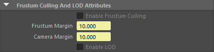

Frustum Culling & LOD Attributes
Enable Frustum Culling See the Crowd Manager Rendering Attributes
Frustum Margin See the Crowd Manager Rendering Attributes
Camera Margin See the Crowd Manager Rendering Attributes
Enable LOD See the Crowd Manager Rendering Attributes

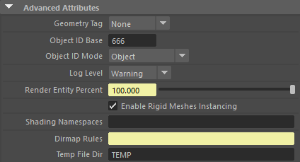

Advanced Attributes
Geometry Tag
Type of Character Geometry Files to use at render time
Object ID Base Start Number for the Object ID pass
Object ID Mode
Mode for the Object ID pass which will be added to the Object ID Base. Several modes are available:
  • Object: one id per Entity Mesh Object - starts at 1, increments 1
  • Shader: one id per Mesh Shader - starts at 0, increments 1
  • Mesh: one id per Mesh (mesh shared among entities will have the same id) - starts at 1, increments 1
  • Entity: one id per Entity - starts at 1001, increments 1000
  • Entity Type: one id per Entity Type - starts at 0, increments 1
  • Character File: one id per Character File (gcha) - starts at 0, increments 1
  • CrowdField: one id per Crowd Field - starts at 1, increments 1
  • All: one id for all (i.e. Object ID Base, see above)
Reference, Object mode, Shader mode, Mesh mode, Entity mode, EntityType mode, Character File mode, Crowdfield mode, All mode
Log Level Golaem Render log level
Render Entity Percent Only render a given percent of entities to save render time.
Enable Rigid Meshes Instancing
Known limitations : Redshift does not handle Ids on instanced meshes (this will be the same Id as the master object).
For each rigid meshes (those skinned to one bone, or parented to a bone, and without vertex cache or blendshapes), the render proxy will build only one complete object definition, and will instantiate it via different transforms and shaders. When using rigid meshes, this saves a lot of memory at render time.
Shading Namespaces Name of the Maya Namespaces to add to the to the shading assignment defined in the Geometry part of the Character files used to export the Simulation Cache (separated with ";"). There must be the same number of namespaces than Character Files.
Dirmap Rules Current dirmap rules to relocate Geometry file (.fbx or .gcg) absolute paths stored in the Character Files (.gcha) at render time.
Temp File Dir Environment variable containing the directory where the temporary VRScene file (for V-Ray) or RIB file (for Renderman) is saved (see "Integration with the Rendering Engine")

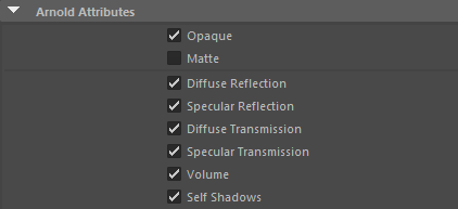

Arnold Attributes
Those Attributes are the same attributes than Arnold standin ones. More information here.

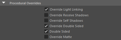

Procedural Overrides

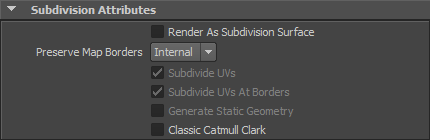

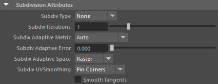

Subdivision Attributes
The Subdivision Attributes are the same attributes than Arnold ones. More information here.

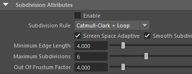

Those attributes are the same as the regular VRay Subdivision Attributes.

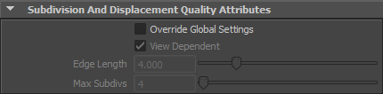

Subdivision And Displacement Quality Attributes
Those attributes are the same as the regular VRay Subdivision And Displacement Attributes.

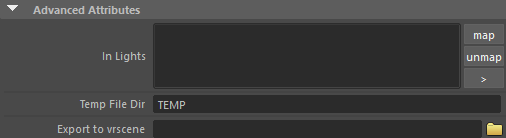

Advanced Attributes
In Lights Lights which will influence the rendered characters. If none, all the lights will be taken into account
Temp File Dir See above
Export to vrscene When not empty, export the expanded crowd procedural in a vrscene file per frame, at the end of each frame render. The frame number is appended to the vrscene file path. This is an experimental feature and only works when Rigid Mesh Instancing is disabled (see global Advanced Attributes above).

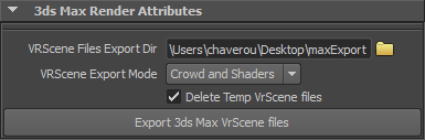

3ds Max Render Attributes
The following attributes are only useful when rendering Golaem Crowd Simulation Caches in 3ds Max with V-Ray. Please check the related tutorial for more information about rendering in 3ds Max.
VRScene Files Export Dir Directory in which the 3ds Max related .vrscene files will be exported (see the tutorial)
VRScene Export Mode Specify which .vrscene files must be exported. If the Render Proxy attributes (motion blur, cache name...) have changed, export the Crowd vrscene. If the Crowd shaders have changed, export the Shaders vrscene.
Delete Temp VRScene Files If checked, all temp .vrscene files generated by V-Ray when exporting the shaders will be deleted. Those temp files are not required within 3ds Max.
Export 3ds Max VrScenes Files Exports the 3ds Max related .vrscene files according to the parameters above (see the tutorial)

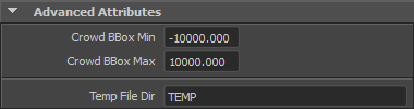

Advanced Attributes
Crowd BBox Min Crowd RIB Archive min bounding box
Crowd BBox Max Crowd RIB Archive max bounding box

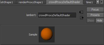

Default Shading
If a Shader Group listed in the Geometry part of a Character is not found at render time, a default Shader is assigned. The default shader corresponds to the shader assigned to the Crowd Render Proxy:

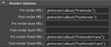

When a Crowd Render Proxy is created it adds four MEL/Python Callbacks in the scene Render Settings. Depending on the rendering engine; those callbacks create objects / files which will be handling the rendering of the specified simulation. When rendering is done, all created objects, attributes are deleted and reinitialized. Notice that PreRender callbacks always call their corresponding PostRender callbacks to make sure everything is clean when rendering starts.
