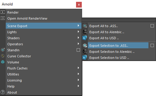

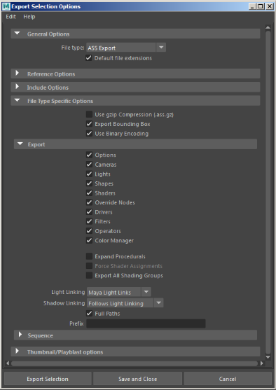

To export the geometry you must:
- Select the geometry you want to export.
- Go to the Arnold > Scene Export > Export All/Selection to .ASS menu option.
- Choose a name for your archive.
- Alternatively, you can export your model as a stand-in via the File>Export All options. The archive is saved as an Arnold Scene Source (.ass) file.
stand-in export options

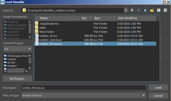

You may export single objects as well as a whole hierarchy made out of multiple objects. You can also export single or a sequence of frames. In this situation, the frame padding value of the Maya renderer options will be used in the names of the ass files. To use the Stand-in, you need to create a stand-in primitive. Use either File > Import, File > Create Reference, or Arnold > StandIn > Create (whichever is most convenient to you, the same dialog will be shown), and specify the archive to be used.
Note that in addition to archive (.ass) files, precompiled custom procedural programs in the form of a dynamic library can also be loaded at this point, though none are shipped with MtoA currently.
Import .ass file as stand-in

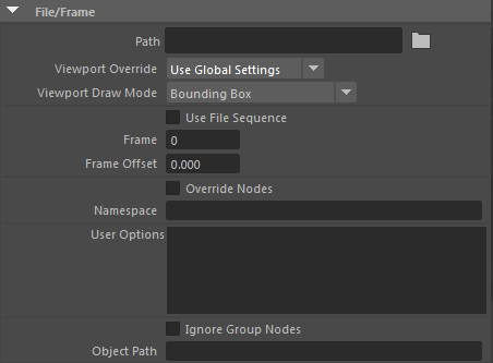

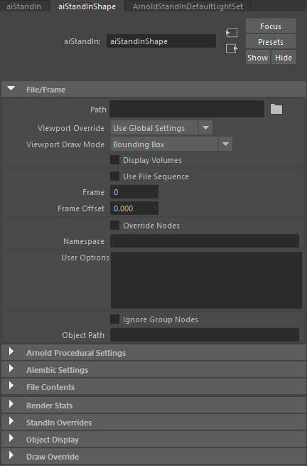

File/Frame
Stand-ins are supported via the stand-in node. This node has the following parameters:
Path
The path to the archive (.ass) file. There is an automatic sequence recognition in the case of an archive.
The padding patterns have this form:
- name.#.ext - e.g. name.1.ext, name.2.ext, name.3.ext, ... , name.10.ext, ... , name.100.ext, ...
- name.##.ext - e.g. name.01.ext, name.02.ext, name.03.ext, ... , name.10.ext, ... , name.100.ext, ...
- name.###.ext - e.g. name.001.ext, name.002.ext, name.003.ext, ... , name.010.ext, ... , name.100.ext, ...
- name####.###.ext - indicates four digit padding for frame numbers and three digit padding for sub-frame digits.
For example: If we point to a file called, test_001.ass it will be recognized as a sequence pattern in the form of test_###.ass. If you want to override the automatic sequence recognition, we can manually change the path string and remove the padding pattern with the corresponding filename.
- A toggle for enabling or disabling absolute/relative pathnames for procedurals (absolute by default) can be found in the System tab of the Render Settings.

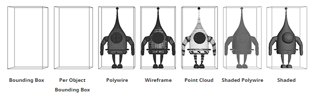

Viewport Override
- Use Global Settings - Uses the Standin Draw setting from the Render Settings to determine how to display the stand-in.
- Use Local Settings - is the default behavior.
- Bounding Box - Display the stand-in as a bounding box.
- Disable Draw - Disables the display of the stand-in.
Viewport Draw Mode
The display mode of the procedural.
Display Volumes
Displays any volumes that are inside the stand-in when in polymesh or bounding_box mode.
Use File Sequence
When enabled, it recognizes the required format and opens the sequence automatically.
Frame
The frame to read that will replace the pattern defined in the Use Frame Extension checkbox. You need to put a Maya expression ('frameNumber = frame') to get a sequence of stand-in to be loaded across the different frames.
Frame Offset
Offset to the current frame. This allows the same animation sequence to be used while creating different procedurals.
Override Nodes
Nodes inside the procedural can be replaced by other nodes with this parameter. This may be used for example to replace shaders in an existing .ass procedural. When the parameter is enabled, nodes in the immediate parent scope of the procedural will replace identically named nodes inside the procedural.
Namespace
Procedurals can declare a custom namespace using this parameter. This custom namespace can be used instead of the procedural name, to reference contents through absolute or relative paths. Multiple procedurals can share the same namespace by using the same custom name. Also, they can declare an empty name and they will use the global namespace.
The parameter "Force Shader Assignments" (that is necessary for this workflow) appears in the export options UI and only appears when "Export Shaders" is disabled.
To export stand-ins and shaders separately, the workflow would be :
- Export your asset with only "Shapes" enabled with "Force Shader Assignment" enabled.
- Export your asset again with only "Shaders".
- Create two stand-ins and load each of them.
- Set the same Namespace string for both stand-ins.

Ignore Group Nodes
It can be used for proxy geometry below the group hierarchy which is then skipped when rendering. Therefore any geometry, lights, etc. parented to the stand-in, won't appear in the render when you activate this parameter.
Object Path
The Alembic path to expand from in the hierarchy.

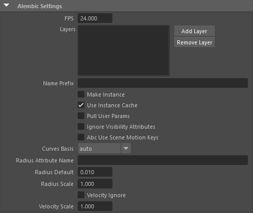

Alembic Settings
More information about Alembic settings can be found here.
Export to Alembic can be found in the Arnold -> StandIn menu.
Arnold alembic export also exports subdivision and user attribute data in Arnold formated naming e.g.
aiSubdivType = subdiv_type
aiSubdivIterations = subdiv_iterations
Abc Use Scene Motion
Sets the number of motion keys for an alembic procedural to the same as the current scene.
Curves Basis
An alembic curve basis override. Auto (default) uses whatever is set on the curve data in the alembic. Choose between:
- auto
- bezier
- b-spline
- catmull-rom
- linear

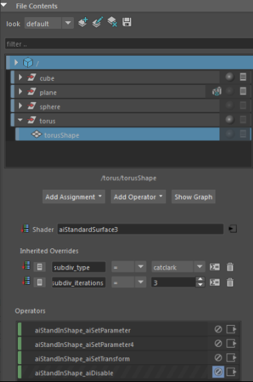

File Contents
It shows the contents of the file in the Attribute Editor and allows you to apply overrides on the selected items.
A scene is available that demonstrate the use of Operators and Assignments with .abc files.

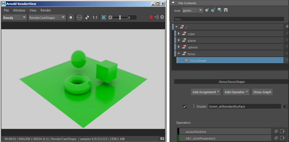

Look

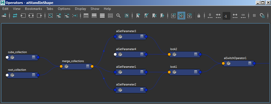

Choose to create, edit or delete look variations. Creating a new look automatically adds an aiLookSwitch node which is a combination of a switch_operator and a merge, which is connected to the root of the procedural graph. When making the first look, the current operators are moved to the first list of inputs on the variant switch node. Labels in the aiLookSwitch are used to populate the menu from the stand-in. This plug can be set/overrode by the Render Setup tools for adding different looks per layer/pass. The name/ look /pass will get translated to an index number for rendering.
'Green' look applied
Add Assignment
A list of parameters that can be assigned to objects within it. It can be used to add attribute and parameter assignments to sub-objects of the node. It creates a set_parameter node for each selection and puts them in order in the Operators list. The top one is the first operator and the last leaf in the hierarchy is the last Operator on the list.
Local Overrides
Assignments that are on the node in the hierarchy.
Inherited Assignments
Overrides that affect the object below or that match the string expression selection.
Inherited Assignments created using far left button

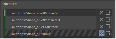

Add Operator
Adds a generic operator to a point in the Graph. The selection string must refer to the nodes inside the .ass file.
Operator list
Show Graph
Displays a standalone graph of the shape and any operators that are connected to it.

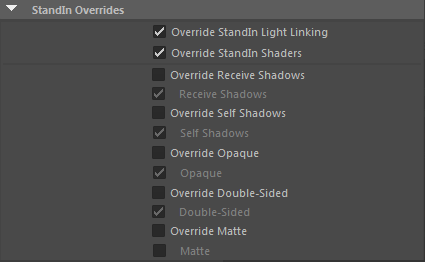

StandIn Overrides
Override Standin Light Linking
If enabled, the light linking of the aiStandin node is applied to all objects in the stand-in.
Override Standin Shaders
If enabled, shaders applied to the aiStandin node override the shaders on all objects in the stand-in.
Overrides the values set within the procedural file. Disabling override_... = OFF would mean that the value isn't forced on the stand-in .
- Overriding shaders does not override displacement maps. Displacement is handled separately by Arnold: when a scene is translated to Arnold by MtoA, the displacement is not part of the "shader" applied to an object.
Extra Attributes
There are some extra attributes (that are hidden from the user), such as overridePrimaryVisibility, overrideOpaque etc. These are located at the bottom of the Extra Attributes in the Attribute Editor of the stand-in (see below). If you use the StandIn Overrides controls, MtoA will automatically update the appropriate checkboxes under Extra Attributes. For example, to override Primary Visibility, you must also enable the extra attribute overridePrimaryVisibility.

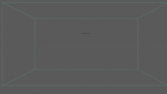

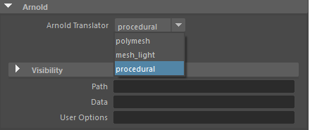

You can use proxy geometry to represent a stand-in using the Arnold Procedural Translator for a mesh. This feature uses the mesh's bounding box information from Maya. If the stand-in is clipped, you can disable Defer Procedural Load, or use the User Options to set the procedural min and max (for example min -1 -1 -1 max 1 1 1).
Polymesh procedural translator
