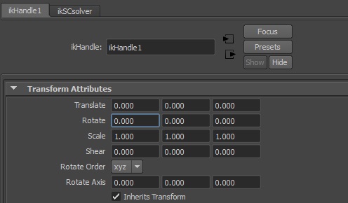

(The IK Handle tool created an iKHandle1 node)
Try to move the ikHandle node, you should see the IK1 and IK2 nodes rotate to ensure that the new_fr_infantry_01_LefttGun1 position is the same as the ikHandle1
This way, when you will move this node, the new IK system will follow and keep the new_fr_infantry_01_LefttGun at the exact same position than the old one.

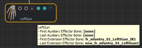

Next step is to add the IK system as a node in the Golaem Character. Just map the first bone of the weapon IK system and the new_fr_infantry_01_LefttGun to a Golaem node:
You can now save the .gcha file, as it’s ready for simulation.
