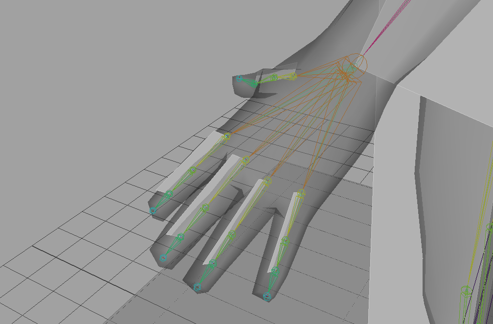

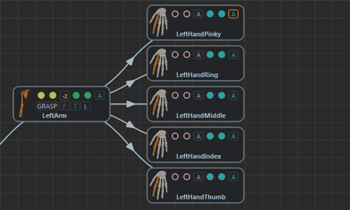

Automatic mapping
The typical result of auto-mapping fingers is as follows:

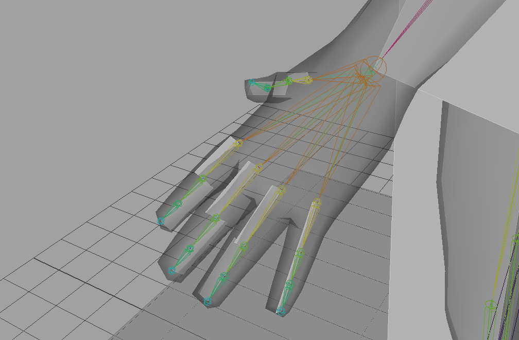

This mapping has 3 problems that can be fixed in 3 steps:
Here are the steps that are recommended to fix this result:

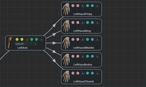

Remap the bone chain to extension part only

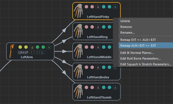

There is a tool to fast remap the auxiliary part on the extension part (right click on each finger node):

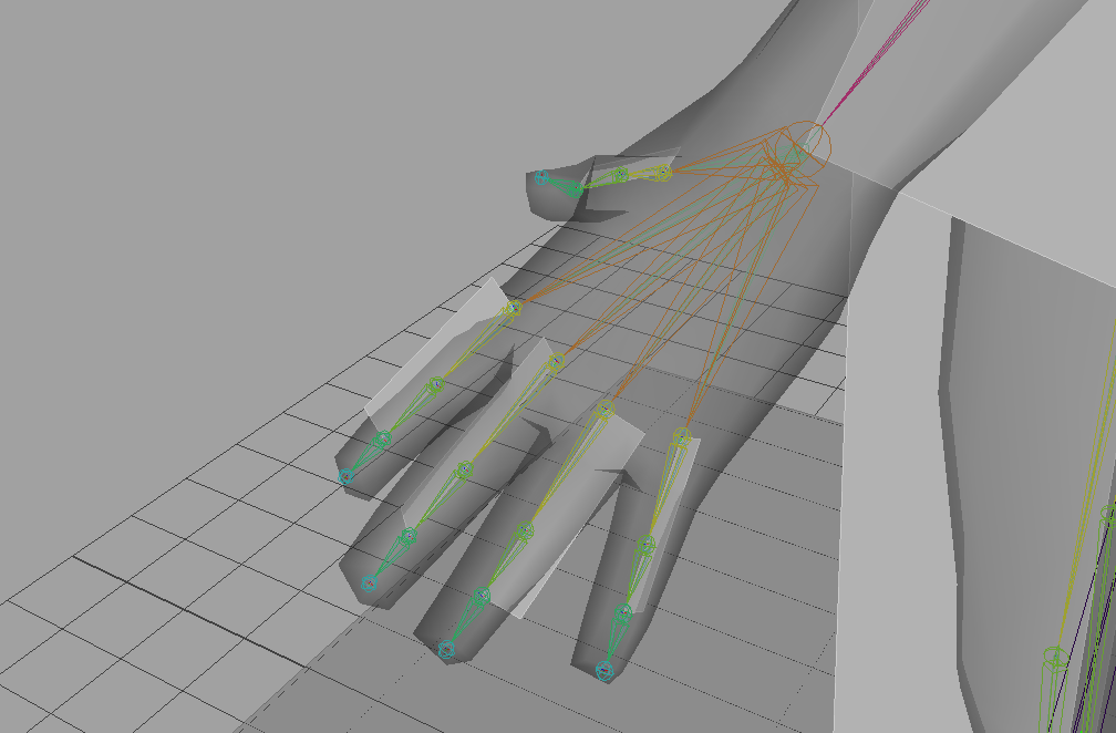

Remove the last bone in the bone chain
The fastest way would be to start by unmapping the last bone in the extension, and then mapping it again to the correct bone.

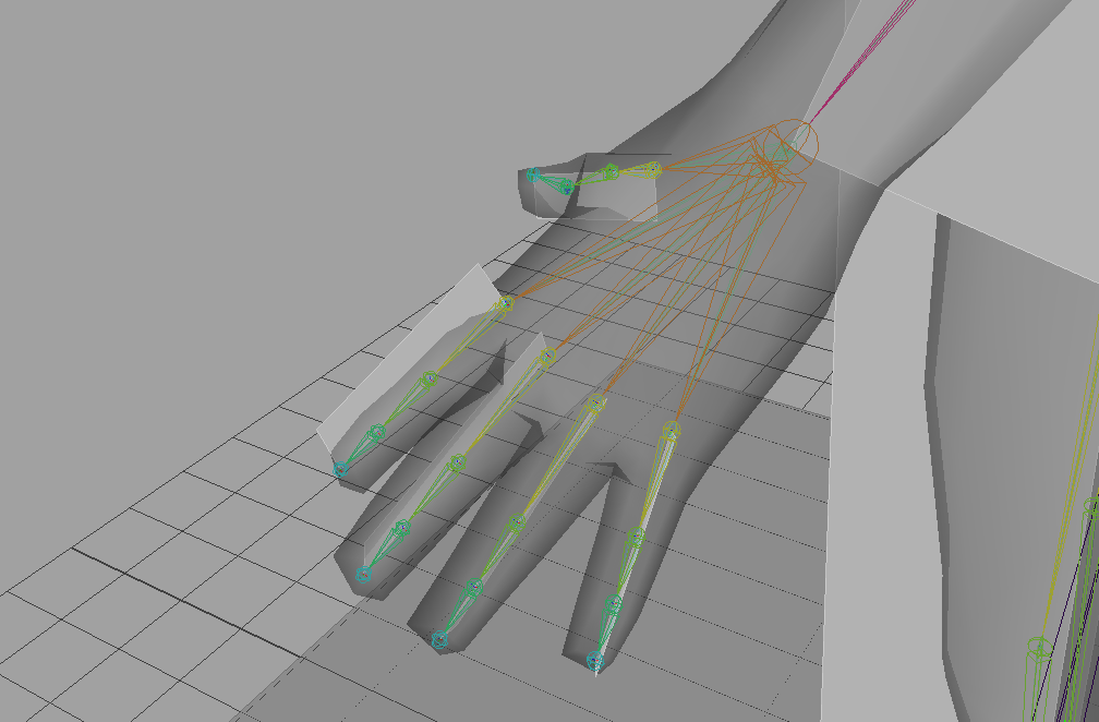

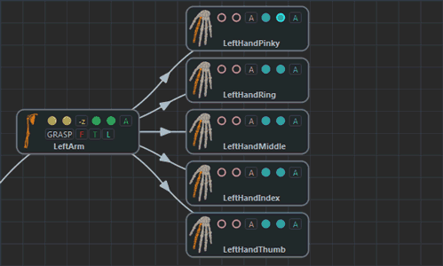

Fix the IK planes
As the finger bone chain most often is flat on the T-pose, it is hard for the automating process to determine the bending side. That's why it is recommended to manually set it.
And Voila!, you now have a finger mapping that should work correctly with the Golaem Character Pack motions, as well as with any other motions that were converted using the same recommended skeleton mapping.
