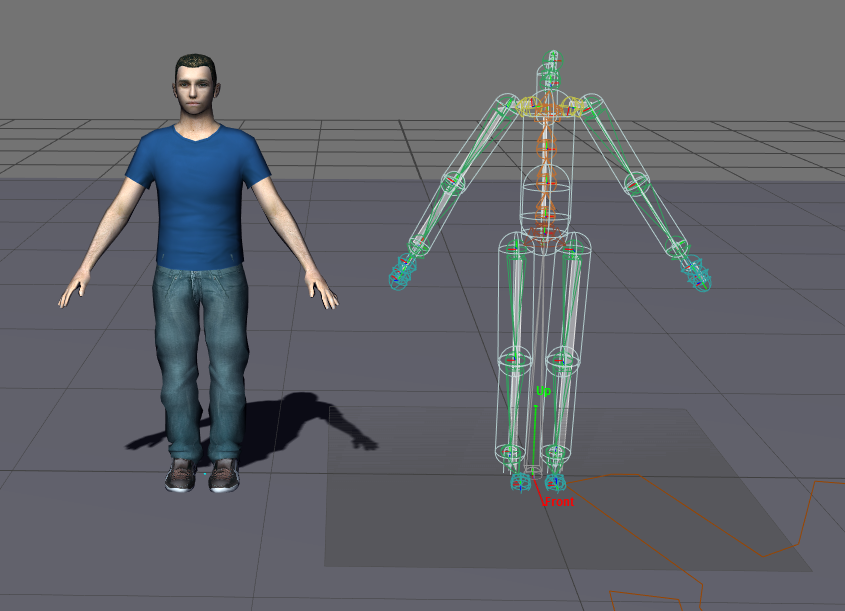

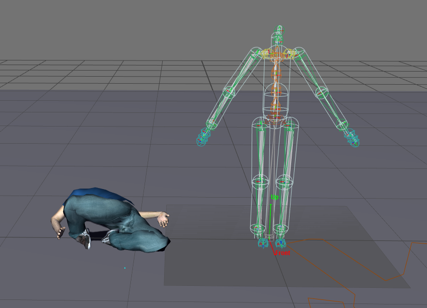

Open your character file (gcha) into the Character Maker. To get a better understanding of what we are doing when fine tuning our character's physical shape and physical properties let's simulate the corresponding Golaem character next to our CharacterMakerLocator.

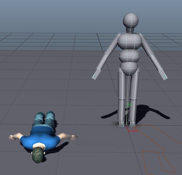

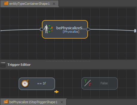

To turn our character into ragdool, go inside the Behavior Editor and drag and drop a Physicalise Behavior on the Behavior Flow and set its Stop Trigger to be activated after 5 frames.
Play your simulation, it's not that bad already (because Golaem automatically set some physics properties for you), but we will improve them in the following sections.

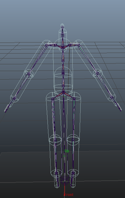

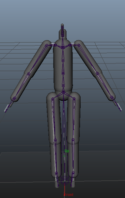

You may have noticed the shapes around each bone of the Character. Those shapes are the Physics Shapes used during physics simulation.
We will transform these shapes to fit our character better.

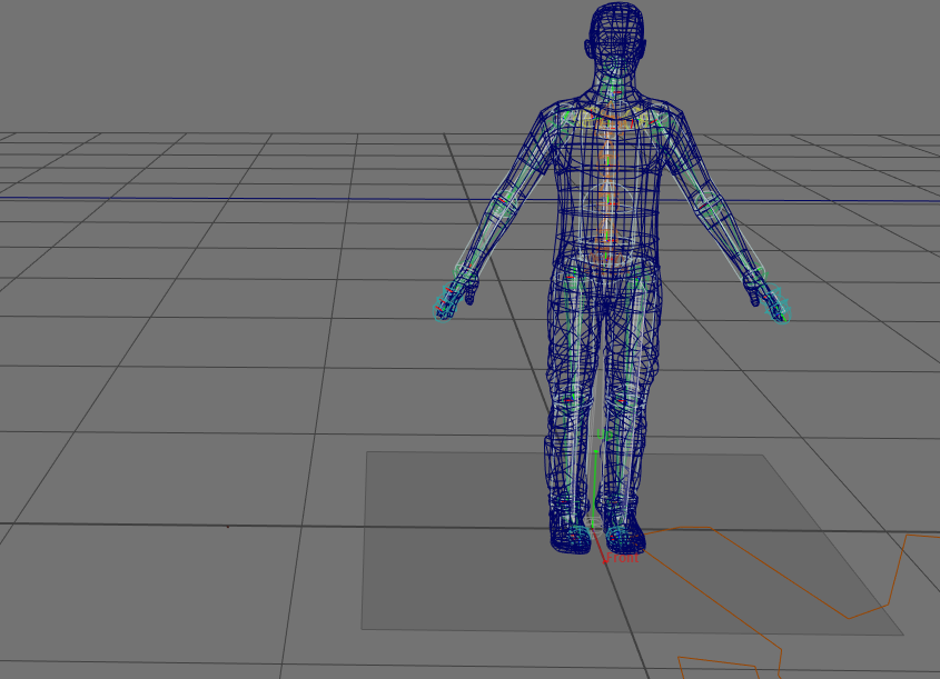

First, you can load your character geometry on top of the characterMaker Locator so that we have a reference for our character shape. It can be a good idea to switch to wireframe to see the Golaem shapes under your character shape.

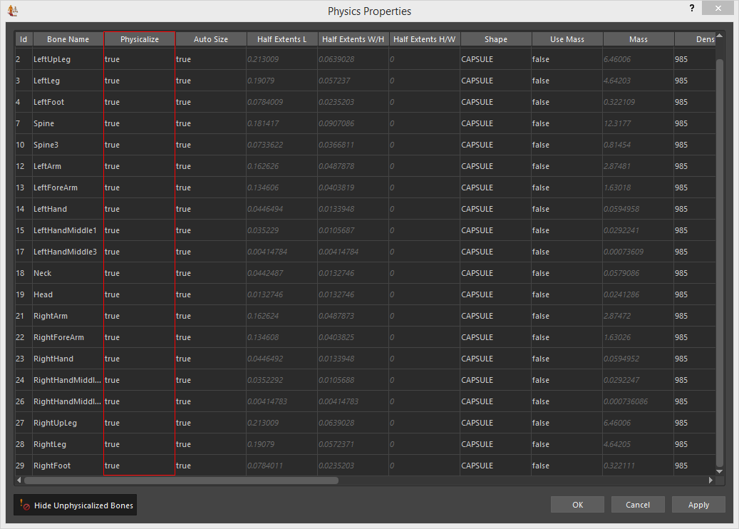

Before starting to adapt shapes to our character shapes, we will make sure that only important bones are physicalized.

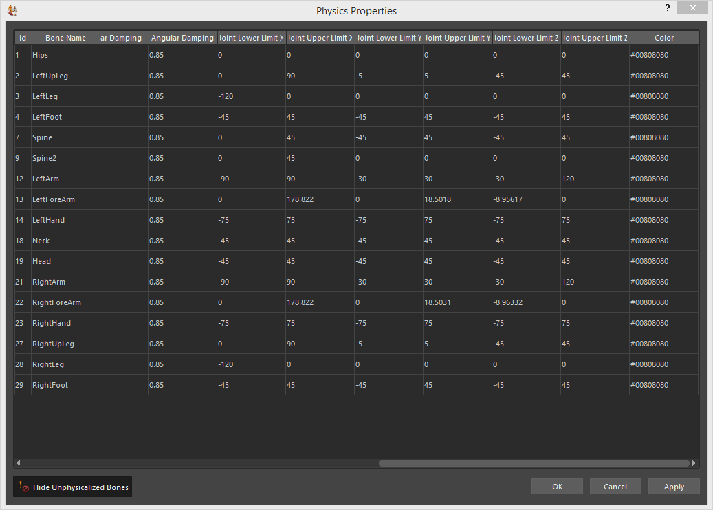

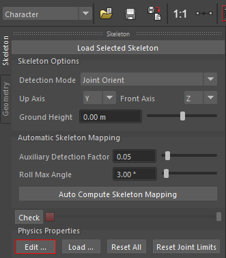

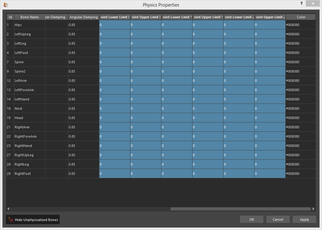

Use the Edit Physics Properties button to load a spreadsheet representing all bones and their physical properties.
As you can see many bones have been physicalized.

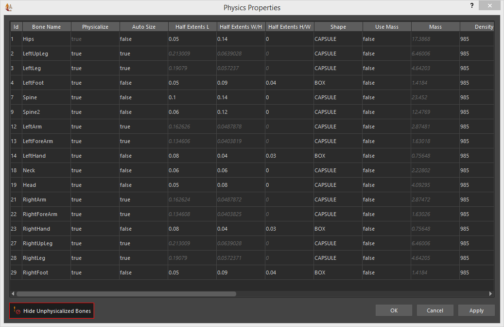

Double click in a cell to edit it. Before being able to edit a bone properties, this bone should be physicalized (physicalize property = true), and to be able to modify its size, the autosize property should be set to false (but let forget about the size at this step, it will be configured later).
See the Reference Guide for Bone Physics Properties for more details about them.
For now let's reduce the number of physicalized bones. For example, in the example below, you can notice that we used a big box on the hand bone representing all fingers. As physics simulation is a computation expensive, it is better and more stable not to physicalize all fingers if it is not needed.
Set the undesired bone Physicalise property to False, click the Apply button. And do not forget to save the .gcha file after.
Note that you can show/hide unphysicalized bones by using the "Hide Unphysicalised Bones" at the bottom left of the dialog.

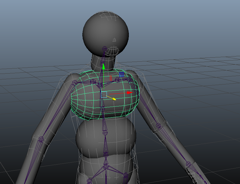

Defining the physics shapes

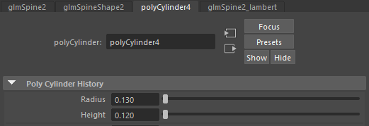

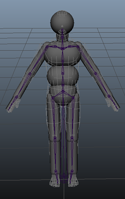

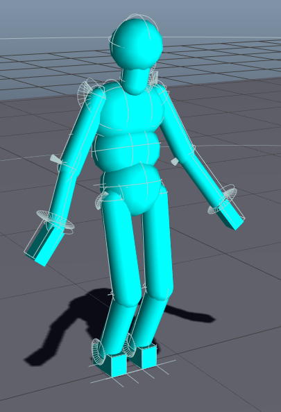

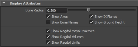

Now that the Physics Shapes are correctly chosen for each bone, let's fine configure the dimensions and positions of each one. Select the Character maker locator, and make sure the "Show Ragdoll Maya Primitives" is set to true:
The physics shapes should now be present as Maya Polygons:
Left: Default Physics Shape Display - Middle: Physics Shape as Maya Primitives - Right: Edited Primitives
You can now directly use the Maya objects to change the properties of the Character Physics Shape, and ensure it fits at best the character's geometry:
Once once the physics shapes fits the character don't forget to save your Gcha.

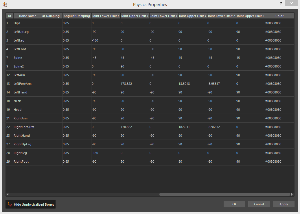

EDIT JOINTS LIMITS
It's now time to give some limits to our character.

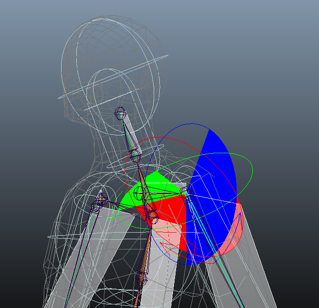

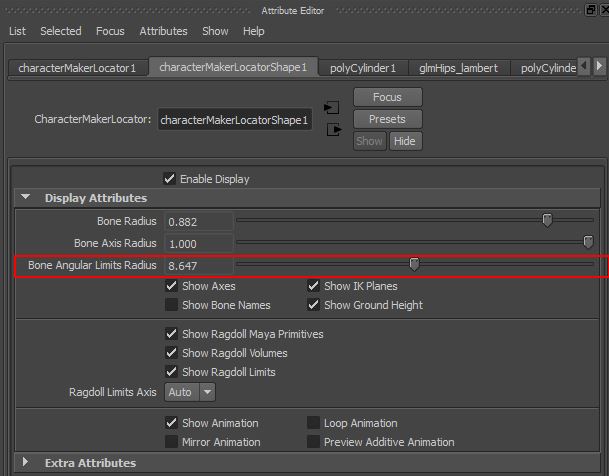

Open the Physics Properties table again and select a physicalized bone to see its Angular Limits
If you do not see the Bone Angular Limits gizmo in the viewport go into the Character Maker Locator's attributes and increase its radius (and also make sure the Show Ragdoll Limits checkbox is checked)
Start with all bones limitation set to zero, this way you will see how the stiffness and damping are taking into account: your character should remain very rigid.
To set values in bulk, not that you can select a whole column (using the SHIFT key), and then (still holding the SHIFT key), double click in the last cell and (now releasing SHIFT) input the value you want to use for all cells.
Joint limits properties (you may need to scroll to the right to find them), all set to 0
Then launch a simulation and check that your character just say very rigid and fall. If it explodes or bend strangely, go back to your shapes and verify you have followed all the best practices.
Caution:
If you experience some instabilities, you can try to change the Physics Locator parameter (increase Physics Substeps and/or Joint Limits Stiffness (correct the position error) and Damping (correct the velocity error). Note that obviously, increasing the Physics Substeps will have an impact on performances.
When you are happy with the results, close the Physics Properties window if open, and click on the Reset Joint Limits button so that Golaem try to determine a few good values for you.
Note that this computations will be particularly good for Angular Limits in the middle of bone chains (e.g. Knee, Elbow) but may be a bit large for others. They are a good start, but they need to be customized.
Angular Limits as set by Golaem
Customized angular limits, they looks like sensible values for any biped with a similar morphology as our CrowdMan Character

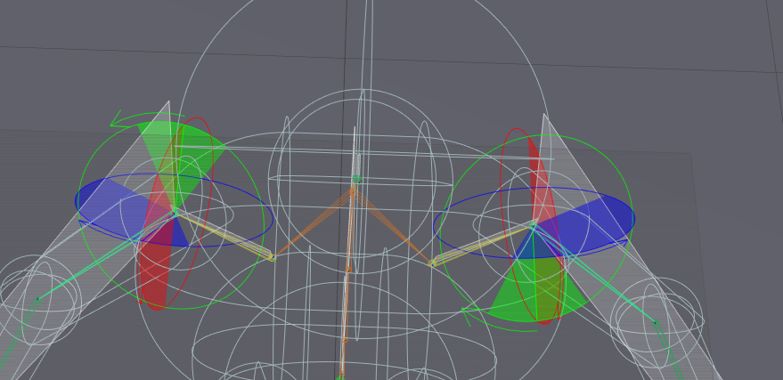

  A few notes on customizing angular limits
When editing the joint limits, depending on how the character skeleton is defined, you will notice that the joint limits can sometimes be displayed with different front angles. You should not worry about this as it has no influence on the values you should use.
Joint limits are displayed with different front angles on each arms.

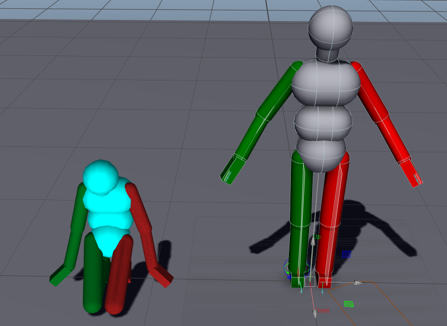

Every Physics Shape color can be customized to be used later in Physics Collision Trigger
The usual setup is to give a different color to left/right or top/bottom limbs so that you can know if a collision happens on left/right or arms/feet
A color setup allowing to discriminate collisions on left or right side of the body
Note that you can customize the display to see these colors or not in the viewport, in the EntityType attributes
