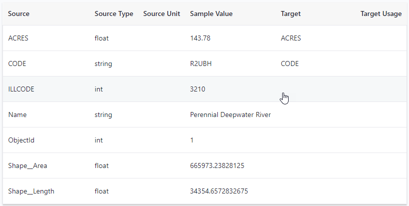

  5. Map the fields you are interested in seeing in Info360 Asset and/or using in CoF or LoF analysis that are based on Spatial Data attributes.
    You can use the Auto Match option to do this automatically.
    Alternatively, you can this manually by clicking on each row and selecting a Target Field.
    You can set the Source Unit by first selecting a Target Usage. Make sure to do this for date-time fields so that these are stored as dates.
