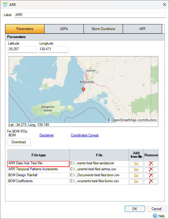

Supply the ARR Data Hub file and BOM design rainfall file and the select the required set of AEP and Storm Durations to be run by the analysis.
Parameters
By specifying the Longitude and Latitude, as well as supplying the ARR Data Hub file and the BOM Design Rainfall file, depths can be calculated for different locations in Australia.
The download button will automatically download and use the ARR Data Hub, ARR Temporal Patterns Increments, BOM Design Rainfall, and BOM Coefficients files from the ARR website.
Latitude, Longitude
Location's position as decimal values. This can be manually entered or selected by clicking the map.
BOM IFDs
Gives links to the Disclaimer and Coordinates Caveat.
Download
Automatically obtains the data (ARR Data Hub, ARR Temporal Patterns Increments, BOM Design Rainfall, and BOM Coefficients) from the ARR website. This will prompt save dialogs to save the data locally. Data files will be updated to show the files have been downloaded.
Data Files
The files for ARR Data Hub, ARR Temporal Patterns Increments, BOM Design Rainfall, and BOM Coefficients can be added or removed manually here. The file location where they are stored locally is also displayed.
