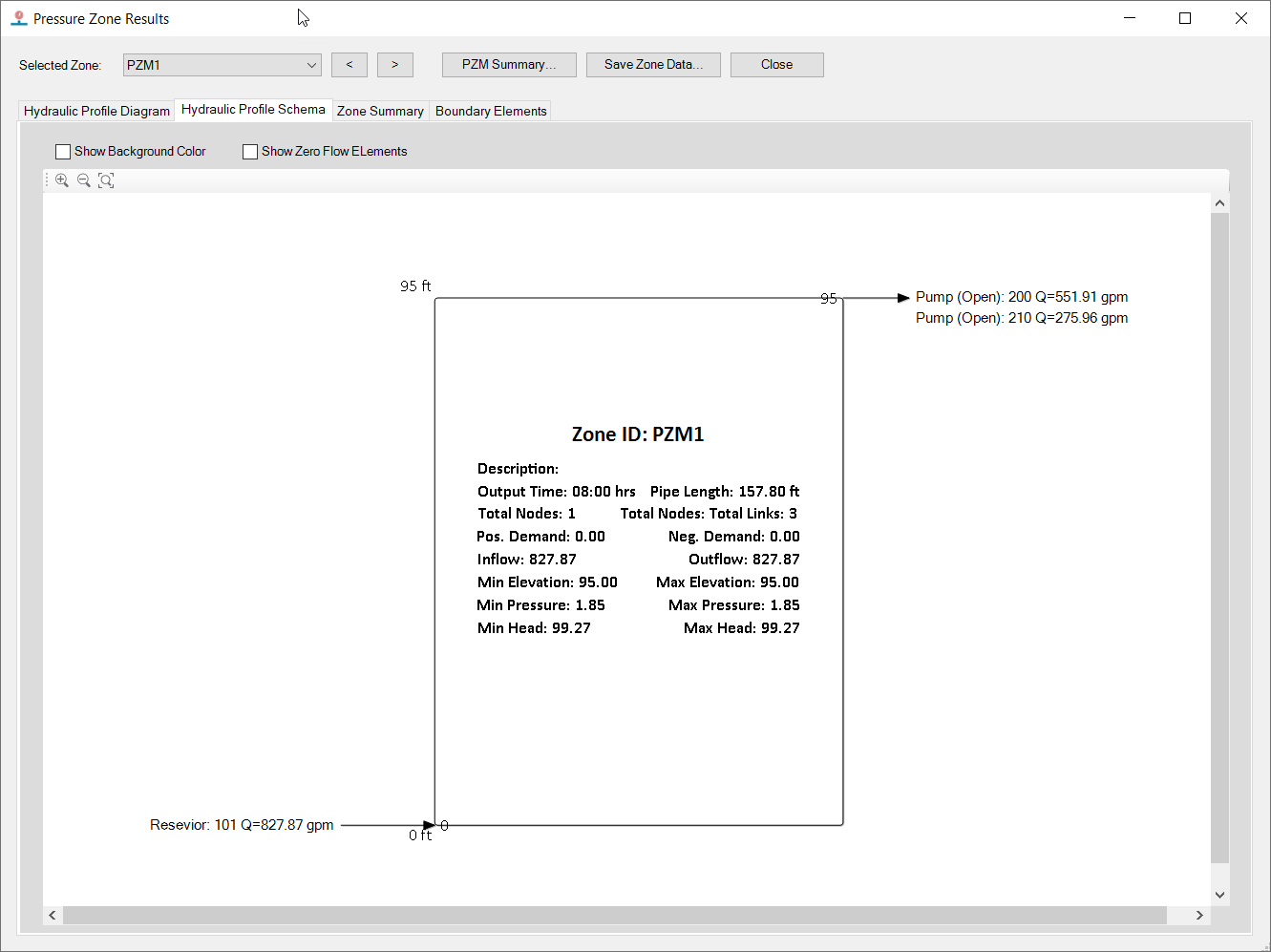

Pressure Zone Results - Hydraulic Profile Schema
The Hydraulic Profile Schema displays the selected pressure zone in schematic form displaying pressure zone data as well as the zone input and output boundaries. Average elevation of pipe boundary elements are displayed where the pipe connection diagramming touches the zone data box.
Pages can be selected for schematics that span multiple pages. Zoom and print functions are available. The schematic may be exported in DXF format or CSV format and saved for later display or printing.
