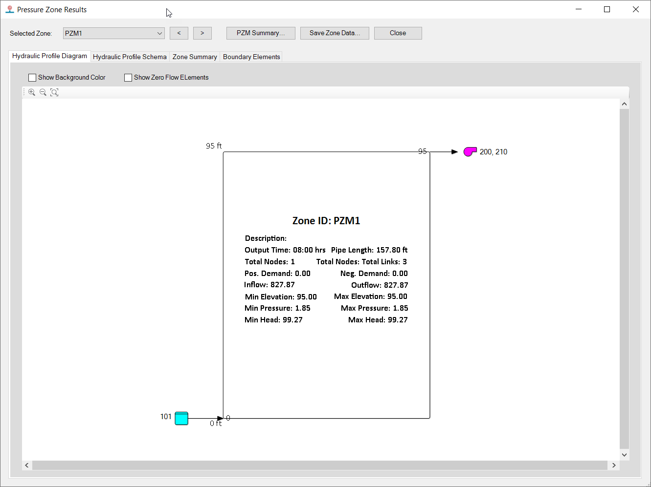

Pressure Zone Results - Hydraulic Profile Diagram
The Hydraulic Profile Diagram tab displays the pressure zone diagram for the selected zone. The diagram indicates zone boundaries with the element symbols and includes element IDs and junction IDs as well as zone data. The zone data includes Zone ID and Description as well as time of simulation, total nodes and links, total length of pipe, positive and negative demands, inflow and outflow, max/ min pressures, and elevations. Average elevation of pipe boundary elements are displayed where the pipe connection diagramming touches the zone data box.
This feature shows all zone inflow and outflow in a graphic form, which makes it easy to visualize the interconnections between pressure zones.
