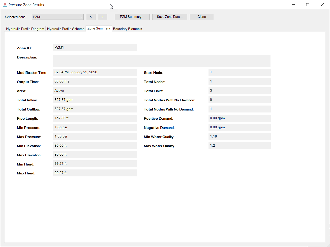

Pressure Zone Results - Zone Summary
The Zone Summary provides a list of details for the selected pressure zone. The zone details include Zone ID and description as well as time, total inflow and outflow, max/min pressure, max/min elevation, total nodes and links in the zone, total positive/negative demands and max/min water quality.
