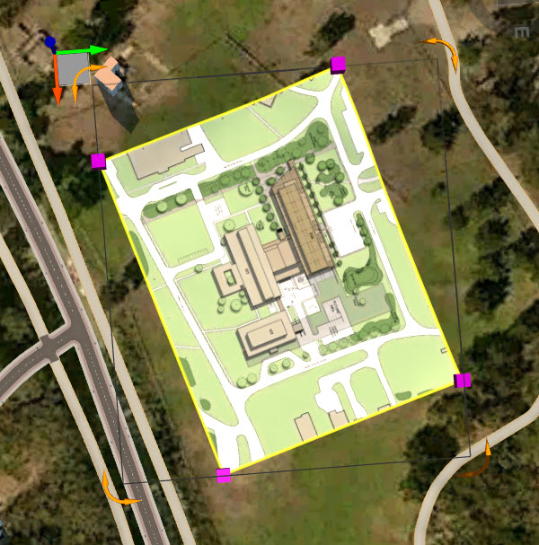

  7. Click Interactive Placing.
    Note: Terrain overlays do not support world files. While not recommended as a best practice, you can manually enter latitude and longitude coordinates in the Position panel within the Data Source Configuration dialog. See To specify geolocation settings for more information.
  8. Click Close & Refresh. Your 2D overlay will be draped to the terrain.
  9. You can rotate, re-size, or move Terrain Overlays in Edit Mode using the grips and gizmos.
  10. To position an overlay more precisely, place by Reference Points. See To position 2D Overlays using Reference Points.
