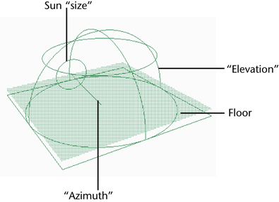

The following attributes relate directly to the Sky’s texture placement object. You can use the Maya transform tools, such as Scale and Rotate to place the manipulator, or use the Show Manipulator tool.
As you change the settings for Elevation, Azimuth, and Size attributes, notice how the various manipulators adjust in the View. IPR render to watch the texture change on the object.
The following indicates which manipulators correspond to which attribute.
The angle (in degrees) of elevation of the sun relative to the floor. The valid range is -90 to 90. The slider range is 0 (sunrise/sunset) to 90 (midday). The default value is 45.
The angle (in degrees) of the sun in the sky about a vertical vector. The valid range is 0 to 360. The slider range is 0 to 360. The default value is 145.
The size (radius) of the sun. The valid range is 0 to 10000. The slider range is 0 to 20. The default value is 0.531
The size (radius) of the halo around the sun. The valid range is 0 to 1000. The slider range is 0 to 20. The default value is 1.

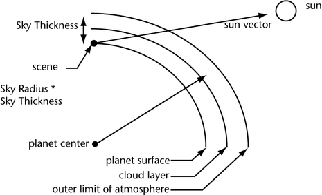

The thickness of the atmosphere. The valid range is 0 to infinity. The slider range is 0 to 10000. The default value is 1000.
The outer radius of the sky as a multiple of Sky Thickness.
Sky Thickness and Sky Radius values determine the planet radius, and planet radius influences the appearance of sunsets. A planet with a large radius results in very red (and very dark) sunsets (you can adjust Sky Brightness to compensate for sunsets that are too dark). The valid range is 0 to infinity. The slider range is 0.01 to 300. The default value is 50.
For example, if Sky Thickness is 1000 and Sky Radius is 50, the outer radius of the sky is 1000 x 50 = 50 000 units, and the radius of the planet is (1000 x 50) - (1000 x 1) = 49 000 units.
