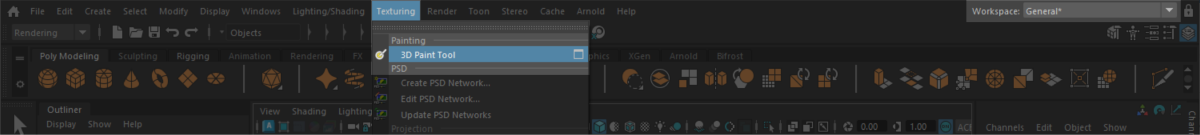

  2. In the Shading menu set, select Lighting/Shading > 3D Paint Tool > to launch the tool and open the Tool Settings editor. See 3D Paint Tool settings. Screencapture of the 3d paint tool in the Maya toolbar.
