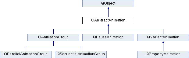

Inheritance diagram for QAbstractAnimation:Public Types | |
