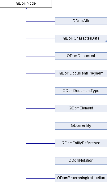

Inheritance diagram for QDomNode:Public Types | |
