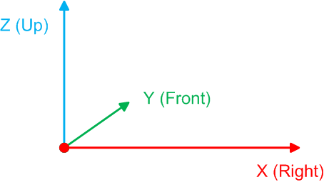

Internally, Autodesk Navigation creates all of its data and does all of its internal calculations using a coordinate system with the following properties:
The axes of this system are defined using the following convention. Note that the positive direction of the Y, or Front, axis is "into" the screen (away from the reader).
This has the following consequences:
If you use a different coordinate system in your game engine, you will need to convert values back and forth. See the following section.
