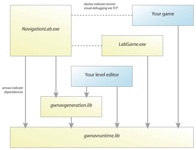

The following image summarizes the relationship between the key components that make up the Autodesk Navigation SDK.
The core code modules are the gwnavruntime and gwnavgeneration libraries:
These core libraries are also used by the Navigation Lab and labgame tools.
Note that actual library dependencies are not necessary for your final release. Clients with access to the full source code for the core gwnavruntime and gwnavgeneration libraries can include the headers and code files in your own project and compile them as part of your game application.
