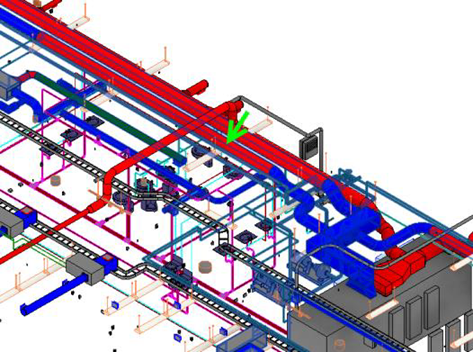

  1. Hover over the supply duct shown in the image, and click on the element. Remain on the element, and press Tab three times, and click on the first element again.

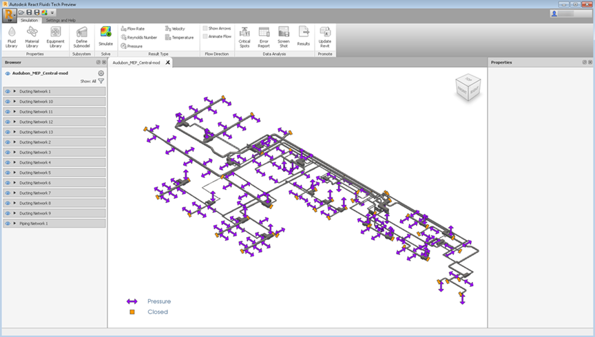

  2. Click Analyze Flow Analysis React Fluids.
  3. Click Yes when prompted to group connected systems into flow networks.
