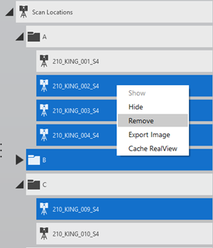

1. Multi-Select Scan Locations
You can now select multiple scan locations by:
- Holding Ctrl to select specific individual scan locations
- Holding Shift to select a range of scan locations

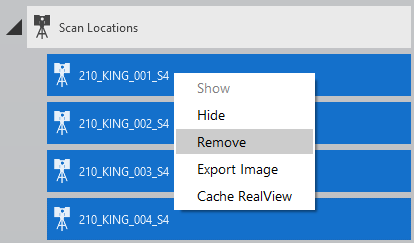

2. Right-Click Remove Option
- After selecting multiple scan locations, right-click on any scan location
- Click Remove

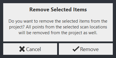

3. Confirmation Dialog
Upon clicking Remove, a confirmation dialog will appear to avoid accidental deletion.

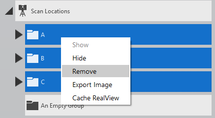

1. Scan Groups with scan locations
Select multiple scan groups which contain scan locations and right click - Remove.

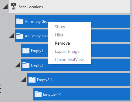

2. Empty Scan Groups
Select multiple empty scan groups (do not contain any scan) and right click – Remove.
