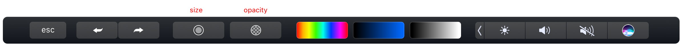

Default
This is the default state of the Touch Bar when using SketchBook Pro. It contains buttons for undoing and redoing an action, as well as for accessing the brush size, brush opacity, slant, or amount/density/strength, and color sliders.
The tool you are in will determine whether certain Touch Bar options are accessible. For example, when zooming in, rotating, or moving the canvas, only Undo and Redo are accessible. When using Fill, Undo, Redo, and the Color Sliders are accessible.
For the following tools, all buttons are accessible: Ruler, Ellipse, French Curve, Perspective Guides, Symmetry, Steady Stroke, Predictive Stroke, and Draw Styles.

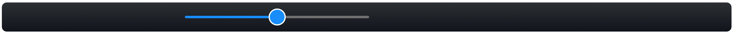

Brush Size
When you tap the Brush Size option in the Touch Bar, this is what you see. Tap-drag to change the size of your brush. When finished, tap Cancel icon (the Quit icon).
The Autodesk SketchBook Pro Brush Size option in the Touch Bar

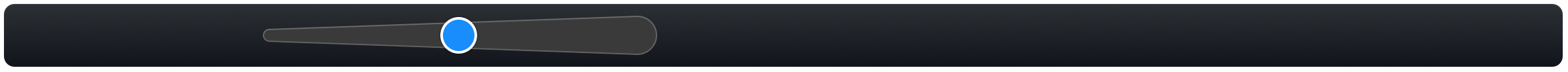

Brush Opacity/Slant/Amount/Density/Strength
When you tap the second button option in the Touch Bar, you will see one of these. Tap-drag to change that parameter of your brush. When finished, tap quit (the Quit icon).
The Autodesk SketchBook Pro Brush option in the Touch Bar

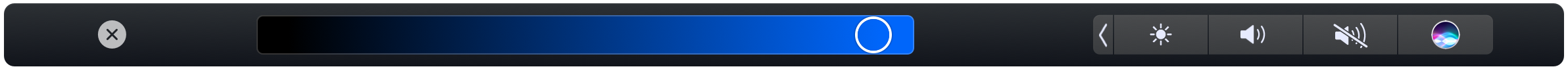

Color Sliders
There are three Color Sliders: Hue, Saturation, and Luminance. When you tap one of these options in the Touch Bar, you will see one of the following. Tap-drag to change the color. When finished, tap The Autodesk SketchBook Pro Quit icon (the Quit icon).
Hue
Select The Autodesk SketchBook Pro Hue icon to change the color used, like from red to green.
The Autodesk SketchBook Pro Hue slider in the Touch Bar
Saturation
Select The Autodesk SketchBook Pro Saturation icon to change the purity or intensity of the color used, like from bright blue to a very dark blue.
The Autodesk SketchBook Pro Saturation slider in the Touch Bar
Luminance
Select The Autodesk SketchBook Pro Luminance icon to change the brightness of the color used, like from bright blue to a faded jeans blue.
The Autodesk SketchBook Pro Luminance slider in the Touch Bar
