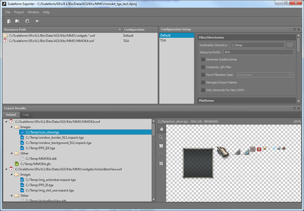

The Scaleform Exporter is a front-end user interface that complements the command line based gfxexport executable. It is intended for testing export options and configurations, as well as for previewing exported assets, such as texture files.
Figure 1: Scaleform Exporter
The tool provides users with an intuitive GUI based export management process and faster iteration when testing different combinations of export options. It also provides a convenient way to preview exported resources, especially textures. The tool also provides an easier way to manage an export process by allowing the ability to save and open the resource entry list and configuration options to a project (.sfproj) file. The tool can accept a .sfproj file path as an argument and will open the project on startup.
The Configuration Setup and Export Results panels are dockable panels and can be repositioned by the user for extended view customizability.
