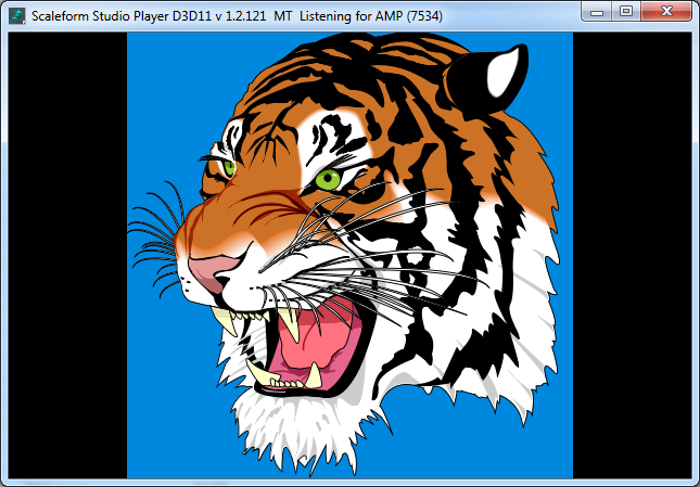

A Scaleform Studio Player can either be
  1. A stand alone player
    • Multiple stand alone players can be launched and loaded with different content. From \Program Files\Autodesk\Stingray\<*version*>\editor\ScaleformStudio, select and double-click any of the player executables.
    • When playing the player stand alone, you can load content by dragging and dropping the file on the player.
    • The player supports bitmap images (.png,.tga),vector graphics (.svg), script files (.lua) and Scaleform Studio Editor files (.s2dscene and .s2dproject).
  2. A player controlled by the Scaleform Studio Editor and associated with a single project. When enabled only one instance of the player is run by the editor at a time. See more in Remotely control a player.
    • When running the player with the Scaleform Studio Editor you can load the content using the Player options in the editor.
