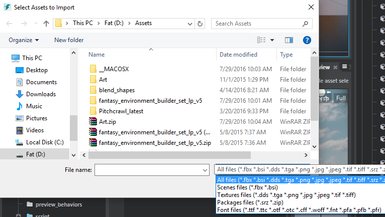

Create a new importer
You can use the imports extension to make your plug-in handle the process of importing new assets of a specified file type. Each time a user imports a file of the type you specify, the engine calls your plug-in to handle reading that file and converting it to standard Stingray assets (like .texture files).
Once your importer is in place, users are able to import your custom file type using any of the import methods supported by the Stingray editor:

types
The list of file extensions the plug-in can import. Required.
label
A descriptive label that groups your types together in file selector dialogs. Required.
regroup
A Boolean value that determines whether multiple assets should be imported in a single batch operation, or as separate actions that are run in sequence. If you set this value to true, each action that you specify in the do setting will get passed the list of all files that the user has requested to import. If you set this value to false, your do actions will be passed one asset at a time, and re-invoked with the next asset until all assets have been imported. Optional.
do
An action or an array of actions that the editor will run when the user imports a file of the type that this importer handles. See Register an action. Required.
priority
If multiple importers are registered to handle the same type of files, this number defines their relative priority. This determines the order in which the editor runs the importers: plug-ins with lower priority are run first. Optional.
options
Custom user-defined SJSON data that the editor passes to each of the do actions in the import sequence. For example, the .fbx import extension shown above includes a .type file specification used by the generic import dialog, and a validation function. See below for more details. Optional.
