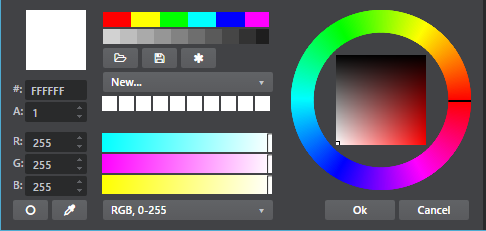

A color swatch with an accompanying intensity slider.
Clicking the swatch brings up a color picker dialog:

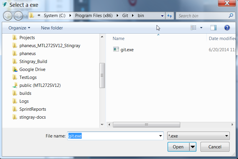

The path property allows a user to select either a folder or a file on disk, using a window provided by the operating system.
| Property | Type | Default | Description |
| browserType | string | Can be either File or Folder. Defines what type of native path selector will be popped. | |
| browseTitle | string | Title of the native dialog. | |
| browseFilter | string | File filter to only show files with a specific extension. |
FilePath = {
type = ":string"
editor = {
control = "PathProperty"
browseType = "File"
browseTitle = "Select an exe"
browseFilter = "*.exe"
DirPath = {
type = ":string"
editor = {
browseType = "Folder"
browseTitle = "Select a folder"
var fileProperty = props.file("File", genModel('c:/Pogram Files (x86)/Git/bin/git.exe'), "Pick an exec", "*.exe"),
var dirProperty = props.directory("Folder", genModel('c:/Pogram Files (x86)/Git'), "Pick a folder"),

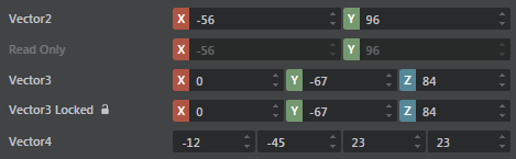

A control that can be used to display a list of 2, 3 or 4 components -- but not a rotation (see Rotation below).
Position = {
type = "core/types/vector3"
// see core/types/vector3.type
export = "#vector3"
types = {
vector3 = {
type = ":array"
value = ":number"
size = 3
default = [0, 0, 0]
editor = {
control = "adskPropertyVector3"
var vec2 = props.vector2("Vector2", genModel([34, 78]), {min: -100, max: 100, increment: 0.5});
var vec3 = props.vector3("Vector3", genModel([1,2,3]));
var vec4 = props.vector4("Vector4", genModel([34, 78, 67, -90]));
