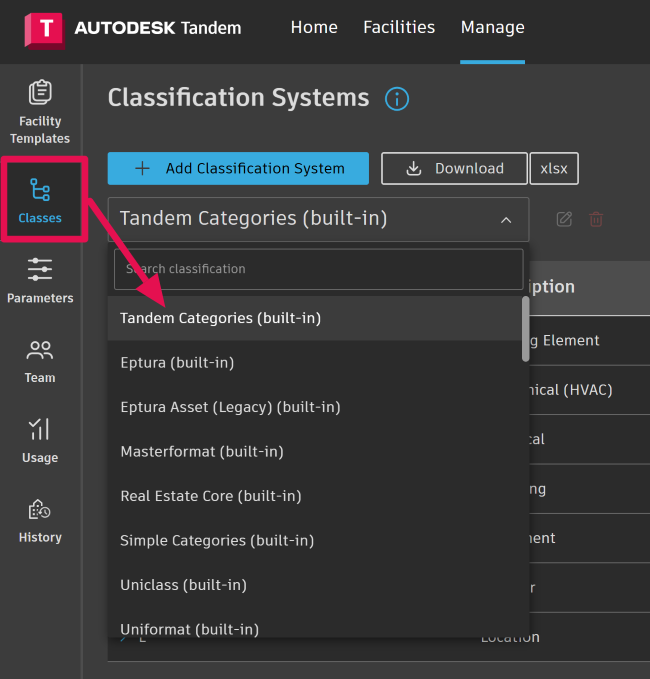

To begin, navigate to the MANAGE page within Autodesk Tandem.

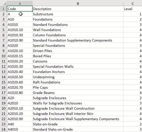

To import a custom system, select an existing system and click download to use as a template. This will create an Excel template to work with. In Excel, you can populate the code, description, and tree level (which defines how the line items will be grouped hierarchically).

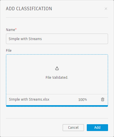

Within Excel, once ready, we can click Add Classification, provide a name, and select the appropriate Excel file.
To review, update, or delete a classification system, you can click the dropdown and select the classification system. If you would like to update the classification system, click update and drag-and-drop the updated Excel file.
Visit our Tandem Categories page to learn about this classification structure
