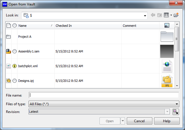

Select Entity from Vault Dialog | |
Allows users to navigate the vault and select an entity for an event. ![]() |

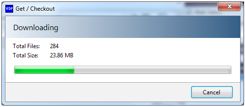

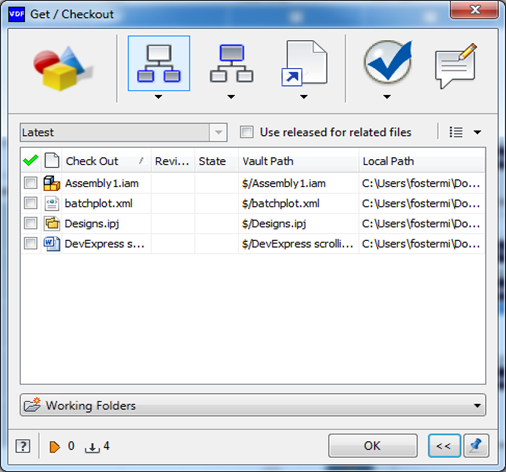

Download and Checkout | |
Allows users to obtain a copy of an entity in a vault. The copy can be downloaded to a local working folder, checked out of the vault but not downloaded, or both. ![]() |

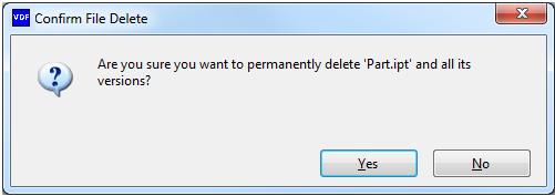

Prompt Dialogs and Management | |
Presents questions to the user in a uniform interface, and allows them to save their response so that they do not have to respond to the prompt again. ![]() |
